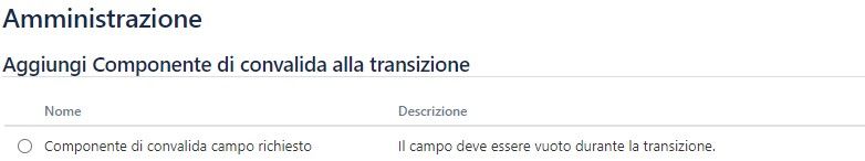

on my instance the translation of this condition is wrong and got me confused:
then searching on the internet the description of this condition is "The field must not be empty during the transition".
Thank u!
