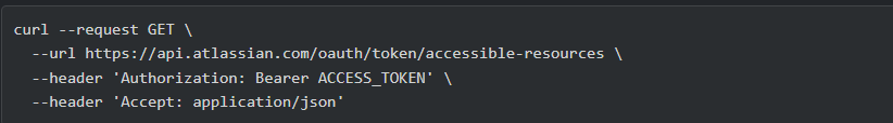

With the access token obtained from the response, we then proceed to request the cloud id using the following request:
The issue we are facing is that this request is returning a blank response "[]", and we are unable to fetch the cloud id.
However, when we attempt to generate the access token using the "three-legged OAuth" or "authorization code grants," and then use this token in the same request as mentioned above, we successfully obtain a cloud id.
In summary, the problem lies in the client credential method, as it does not return the cloud id as expected, whereas using "three-legged OAuth" or "authorization code grants" does give us the desired cloud id.
