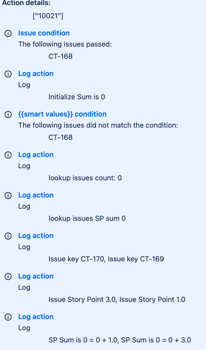

I have looked through the automation references and other similar automation rules but cannot get my automation to work and would love some insight on what the problem is.
Attached is the log debug statements. Thanks in advance

To use the {{lookupIssues}} smart value you must first have used a Lookup Issue action. I believe you should be using that action instead of the Branch For Children, in this case. The Branch For Children changes the focus of the rule activity from the parent Epic to the child issues, and would execute each action under the branch for each child.
Instead you should use the Lookup Issues action to execute a JQL that will retrieve all the child issues of the parent Epic that triggered the rule.
Then you get the sum of Story Points for all the issues returned in the Lookup Issues action with this smart value:
{{lookupIssues.Story points.sum|0}}
And you won't need to create or use a Variable at all.
