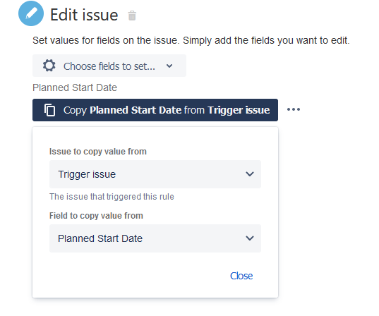

What actually would have helped a lot, would be if I could look at the code behind the things that you can choose within the GUI. E.g. in the screenshot below, I'd like to know what the fields are doing in code. I would have been able to copy/paste the lookup function for the trigger issue planned start date. Is there a way to check this code?

Here's the input for the edit Issue:
According to the rule audit log, it triggered correctly, chose the correct story out of the 5 available and edited the Planned start date. However, I can't see that change. (I guess I can kill the filter looking for stories. seems obsolete)

What I find weird is that if I use the "copy from" function via the GUI without adding business days or the like, it works well. Also, "{{Now.PlusBusinessDays(5)}}" works as advertised. Therefore, the trigger and date-shift work as it should. It's just the editing of the cell that is buggy in combination with the lookup function
However it apparently works to lookup and copy/paste the unaltered date. Can we somehow look at the code behind this GUI controlled command so that I could copy it and add the date-shift?

As mentioned above, commands like {{now.plusBusinessDays(5)}} or just {{now}} work and edit the correct field in the correct Story with the appropriate date (--> trigger and conditions work, as does the date shifting and editing of the field). For me this looks like the issue still is the lookup function.
Is it possible that it is a problem with how the date is displayed? I always have to input date in format DD/MMM/YY, but it is generally displayed as DD.MM.YYYY (standard european).
I tried to look at the code behind the GUI shown above (also works as advertised), but could not find something that I would identify as the lookup function. I guess this is hidden deeper within the code library.
