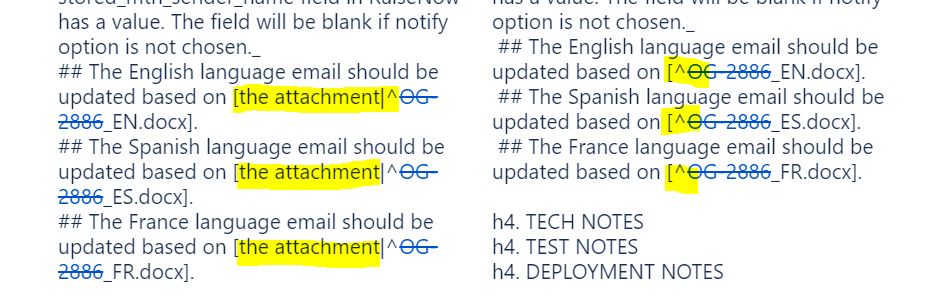

Example before and after, note that text for link disappears

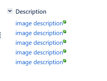

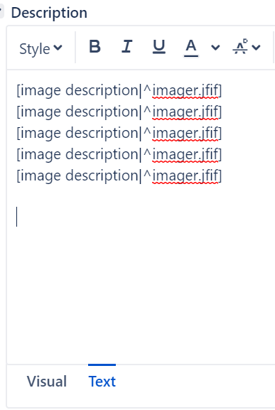

It appears to happen if the editing mode is switched between "Visual" and "Text". The following 3 examples show me adding some additional text after the links. I did not touch the links after first adding them.
