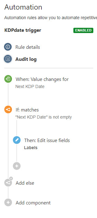

I have a custom date field , I need to use automation which will add a label once any of the user changes the date manually but only for the second time so as to then add the label as Re-Planned , but for all my tries the label is getting added even for the first time when someone selects a date from empty state .(want the label to be added only when it has a value before) Can you please guide me the automation rule here may be using smart values ? Thanks! @Bill Sheboy
Just Fyi I have also tried else condition but that doesnt make any difference either.

I believe this needs a couple of conditions...assuming the trigger is specifically on your date field changing.

- At the point where I had to select edit issue fields action - labels It allowed me to create a new label and add.

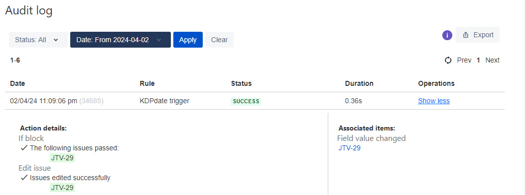

- Regarding {{fieldChange.fromString}} i did try that aswell . attaching the audit logs and rule. It passes saying did match condition :( - So i create a issue , then edit it to have a date , then change that date .
Can you use the Log Action to print the {{fieldChange}} smart values for fromString and toString into the log before the Condition step?
First thing: the trigger is the generic one for Issue Updated. I recommend changing that to issue Field Value Changed. That will help focus your testing as the rule you show could be triggering on other issue changes.
Next, let's map out the cases so you can exercise them. Please adjust accordingly.
Next after the trigger, write to the log with the values of {{fieldChange.fromString}} and {{fieldChange.toString}}. Those will help confirm the values the rule can see before making further changes.
Hi attaching the audit value results ,

The rule you have now basically says if the field has been change and the change did not clear the field, then add the label.
Previous value | New value | Add Label? |
blank | some date | Y |
some date | blank | N |
some date | some other date | Y |
If it should only add the label in the last case, then you need to check what the value was before the change.
After triggering the rule you need to add a Condition to check the previous value of the field.
With the Field Value Change trigger you have access to a special smart value that gives you details about the change. That smart value is {{fieldChange}} and is mentioned in the description of the trigger here.

Although i did try using smart values as attached image but failed to get a value of the field .
I think when the date is changed for more than 2nd time I would not need the label added . Thanks
