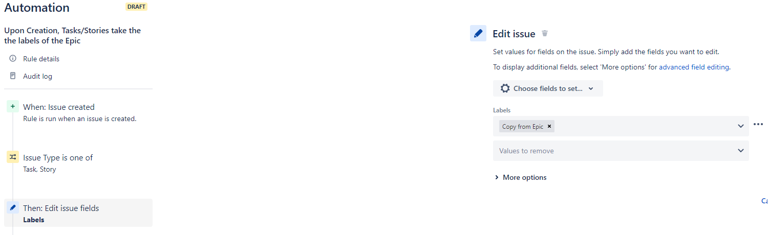

Our team has adopted a new organizational method, via specified labels on all of our Issue Types. Unfortunately, I have run into a problem where I am manually applying all of the labels to the Stories/Tasks within my Epic.
My initial goal was to proactively Label the Epic with the Team and Project Code, and have any issues created under the Epic automatically take on the labels of the Epic.
I have been able to create an automation to make sub-tasks copy the labels of the Parent Issue, however, when I apply the same logic and use the Action: "copy from epic", the audit log informs me that it could not find the Epic to pull the information from.
Is there something I should be changing below to get this automation to work?

Hi @Mizael Ponce -- Welcome to the Atlassian Community!
Your want your rule to trigger when a child issue (e.g. story) is created...and it already points to an epic.  Is that correct?  If so, you want watch for timing problems with the Issue Created trigger and copy directly from the Epic.
  • trigger: issue created
  • action: re-fetch
  • condition: issue type is Story or Task
  • action: edit issue, setting the labels from the Epic (this is an option from the field edit via the ... at the right side of the field)
What do you want to happen if the Epic Link for an issue changes later?
Kind regards,
Bill
Mizael Ponce June 2, 2022
Hi @Bill Sheboy ,
Thank you for that suggestion! The automation is working smoothly now.
Regarding your last question, I want the Issue types to take on the labels for whatever Epic they are currently linked to.
