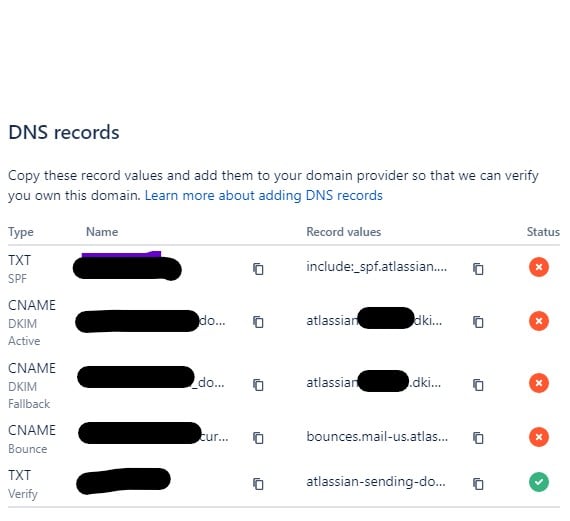

I am thinking to upgrade to the pro version, but I am a bit confused about what is happening with DNS verication.  I have added (as suggested) all the values on my Cloudflare, but only one has been validated. I tried to take a look at the community but I haven't found anything helpful. Is there someone else who faced and solved it?

The free vs paid site won't make a difference here.  It looks like you are trying to follow the steps in https://support.atlassian.com/user-management/docs/verify-a-domain-to-manage-accounts/#Verify-over-DNS
But I can see that you are missing several expected DNS records here.  For example, when I ran a terminal command to lookup the DNS txt and cname records of your domain, such as
% dig curzon.com CNAME

^ there are no entries in the ANSWER section which would seem to indicate you don't have the 3 CNAME records we expect to see on your domain.

The last record is correct, and verifies according to your screenshot, but the TTL (time to live) values are extremely low (300).  Our documentation indicates we expect a value of 86400 instead.  The problem can be with low TTL here is that our services would have to invalidate the cache of DNS records within 5 minutes, requiring a new lookup to your DNS server each time.  If that fails for any reason, it can also cause the check to fail.
So to fix this, you will need to copy the values on your screenshot and create the appropriate DNS records on your domain.  Once that is done, it could take a few hours for our services to automatically attempt to check this and verify again.
