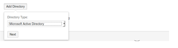

  1. Go to user management as Jira Administrator them choose user directories and then click on Add Directory , under Directory Type Choose Microsoft Active directory if you are using AD or LDAP which ever the case might be in my case i use active directory and then click NextSelection_059.png

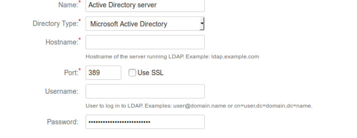

  2. You will be prompted to the next window which is the Configure LDAP User Directory window and then you have to fill in the required fields and other fields on the server settings Selection_060.png
  3. Directory Type must be Microsoft Active Directory in this case, next is Hostname of the server running your Active directory enter your hostname for example ldap.example.com by default Port number is 389, if you have SSL(Secure socket layer configured to the server running your AD(Active directory or LDAP) then Check Use SSL, the default number will be changed to 636
  4. Next is the User name and Password you will need to have a user(special) that will access LDAP/AD for Example the syntax for Username is user@domain.name or cn=user,dc=domain,dc=name. Where cn means common name and dc means domain component. And then enter user’s password.

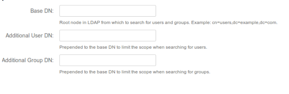

  5. So far so good, Next in line is the LDAP/AD scheme which has the field Base DN (Base Distinguish Name) here you will need to fill in the rootnode in LDAP/AD from which to search for users and groups. How to get the base DN ? you will need to log in to your LDAP or AD and right click on the container where users and groups are keep inside for example container RD , once again go to Properties Attribute Editor a nd look forthe attribute distinguishedName, there you will find the correct syntax for the user for example OU=RD,DC=mega,DC=megaint,DC=com Selection_061.png

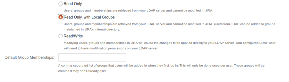

  6. Now you will have to set permission under LDAP permission scheme, here you should choose Read only,with Local Groups so that you can add groups from jira internal directory to LDAP users.Selection_062.png

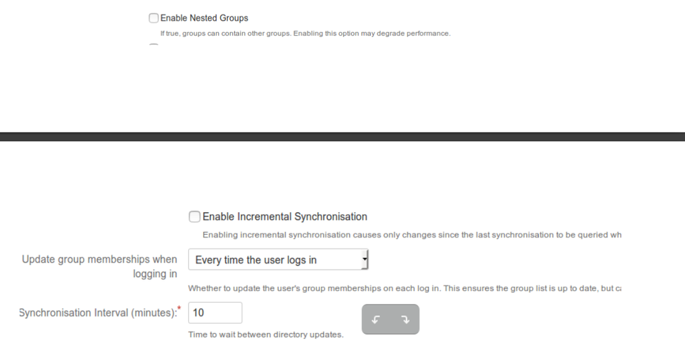

  7. Further more, we have the Advanced setting here you need to be a little bit careful with the fields you mark checked. make sure you don't enable Nested groups because in our case we shall be managing group from JIRA Internal directory not from LDAP/AD it self, and our JIRA instance is not configured to have nested groups and in fact when you have your JIRA instance configured to have nested groups and you are managing groups which are nested in JIRA internal directory this could affect logging in, permissions, and viewing and updating users and groups, thus degrading performance, Incremental Synchronization should also be unchecked, Update group memberships when logging in should be set to Every time user logs in and Synchronization interval should be set as you wish (5mins should be fine )Selection_063.png

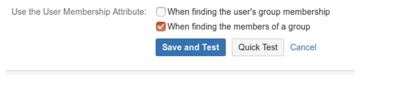

  10. The final thing to do is to configure the Membership Schema Settings you will only need to check When finding the members of a group under the Use the User Membership Attribute field all other field are filled in by default and should not be modified.Then click save and test. Now you will have to try to login with an active directory user which you added to group Active_Jira_users, Active_confluence_users, which is responsible for user access.Selection_066.png
