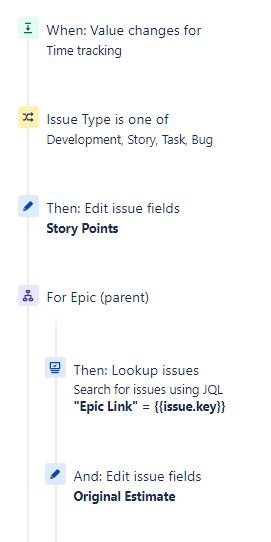

This automation solves the problem of calculating the sum of the original estimate of all issue types of an epic, without the use of an addon. Keep in mind that I had 4 different issue types (standard tasks) from which I wanted to sum up all original estimates and not story points.
Below you will find my rule, which after testing it, it works like a charm:
So what the above rule does is that
Below you will find each individual rule component.

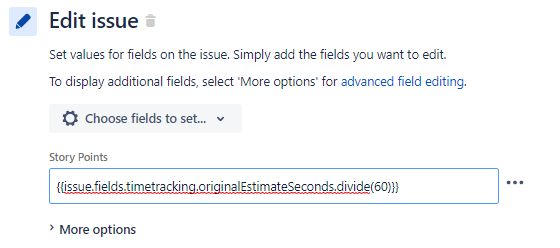

{{issue.fields.timetracking.originalEstimateSeconds.divide(60)}}

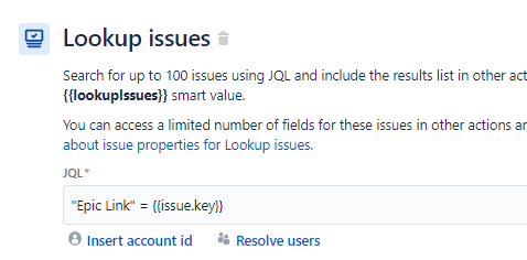

{{lookupIssues.Story Points.sum}}
