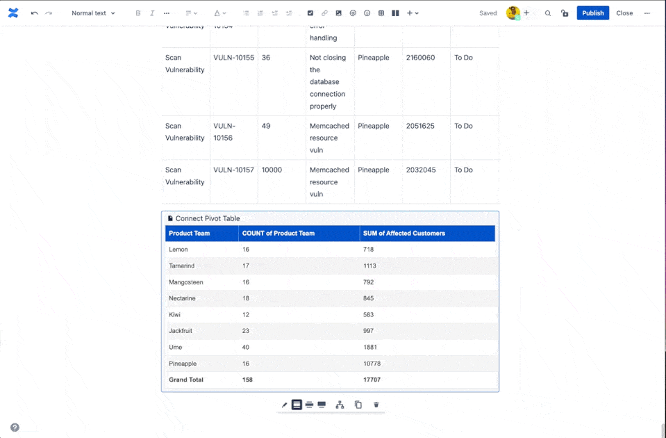

Table Extensibility allows elements, such as a data macro, to act as the source of another element. Confluence Cloud users can then create transformer macros – such as pivot tables – or build visual charts that reference the data in a source table. Additionally, users can chain multiple macros together to create a more complex relationship between multiple sets of data. This allows real-time viewing of the visualization as the data changes.
Using the Connect Data toolbar item available in supported Connect macros, users can open the Connected Data Panel. In the panel, users will be able to view and configure connections and create macro data chains on a page.
Currently, we support three types of data chains:
  1. Native Table to Connect Macro
  2. Connect Macro to Native Chart
  3. Connect Macro to Connect Macro

Tables will become more complex and will be able to combine many data sources into a single visual presentation. These complex tables will become the source data for sophisticated charts and visualizations that will update in real-time as you edit the source data.
