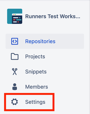

Adding a new workspace runner in the Bitbucket UI
By using runners within a workspace, you will be able to run builds in Pipelines on your own infrastructure for any repository in the workspace. You can have up to 100 workspace runners.
  1. To register a new runner, go to the workspace you would like to create a runner for. To select a workspace, select your profile and settings avatar and select a workspace from the Recent Workspaces list or select All workspaces to open a page listing all the workspaces in which you are a member.
