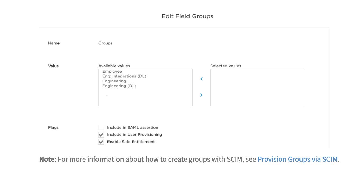

I am trying to do the automated user provisioning from OneLogin to Atlassian Access and doing so with the help of this guide:
https://onelogin.service-now.com/support?id=kb_article&sys_id=05501489db792708ca1c400e0b9619ea
Everything seems to work fine and it says the user has been provisioned in the onelogin backend, however i cant pull my groups from Atlassian Acces as it shows on the picture below. I have a blank box instead. I have been through this guide about 20 times followed the steps properly. Anybody has any idea what else can be done?

I have gotten an answer since which is this:
Hi Máté,
If you're setting up SCIM automatic user provisioning for the first time, your Org in Atlassian Access won't have any groups associated with it, so when OneLogin or you query the API you'll get zero groups returned. You might have groups that already exist in your Jira site, but those are in a tenant/site context and not global, so those aren't the same groups that OneLogin would pull.
To set up groups in automatic user provisioning, in your OneLogin dashboard you would go to the "Roles" tab in the "Users" dropdown. Creating these Roles corresponds to a SCIM group; you could then assign users to these roles and push the group in the parameters tab for your app as seen in OneLogin's documentation.
We'll follow up with OneLogin to clarify and update the documentation, hope this helps!"
I tried this as well but it doesnt at all still, could anybody help please? Have been waiting for this for a long time.
