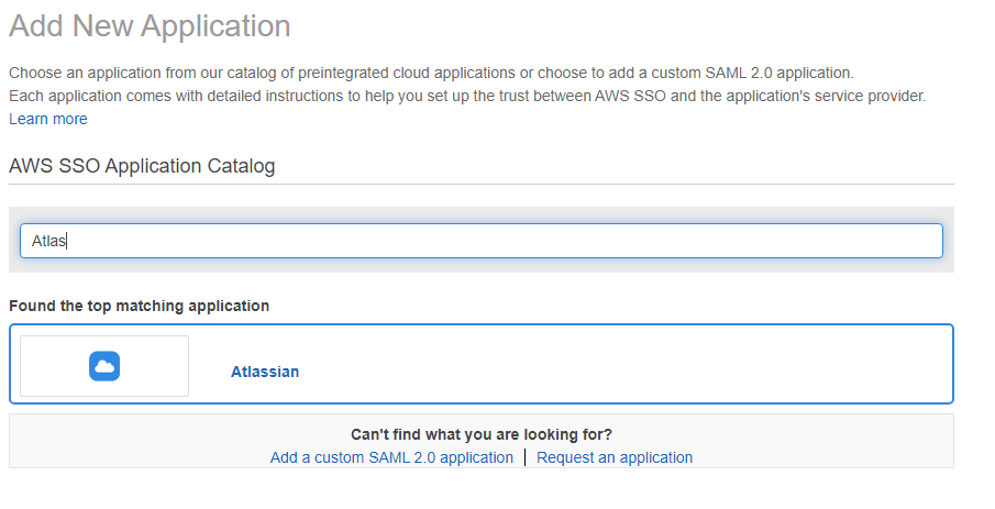

I have an AWS managed Active Directory and I've setup AWS SSO for it. Now its time to add my SAML 2.0 applications.
We currently use 3 Atlassian products (and we also have Atlassian Access):

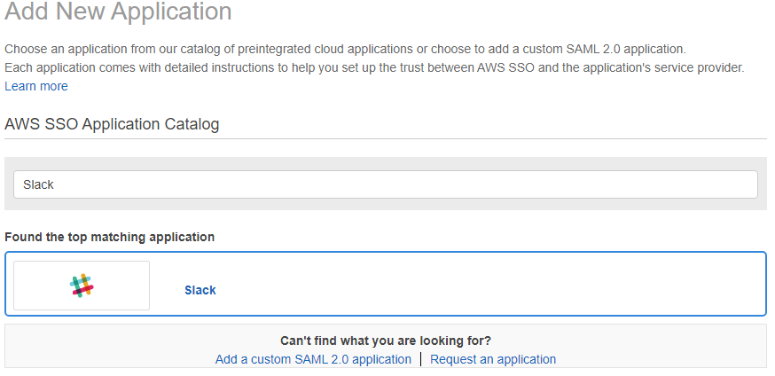

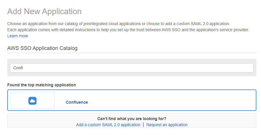

When I search for supported applications in AWS, I can see "Atlassian", "Confluence" and "Slack". What is the difference between "Atlassian" and "Slack" ?
Eg. See below screenshots from AWS Console:

Hello, @David Co
Slack is cloud-based service completely different from anything Atlassian-related.
"Atlassian" application in AWS directory most likely refers to Atlassian Cloud, which includes Confluence (as well as Jira). In Cloud you don't SSO into Confluence or Jira, you SSO into the whole Atlassian Cloud.
"Confluence" might be referring to Confluence Server or Data Center – an on-premises installation of Confluence.
