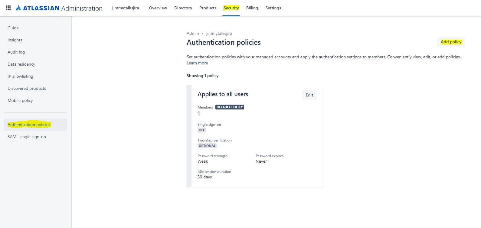

  1. you will need to get to the Atlassian Organization Admin page, which you can do by navigating to https://admin.atlassian.com, then selecting the Organization you wish to manage.
  2. Next, you will want to navigate to the Security → Authentication policies menu options
  3. If you don’t already have a security policy with “two-step verification“ set to Required, click Add Policy (otherwise skip to #5 )

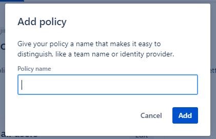

  4. In the popup, enter a name for the policy (use something that will make sense later like “Enforce 2FA“), then click the “Add“ button.

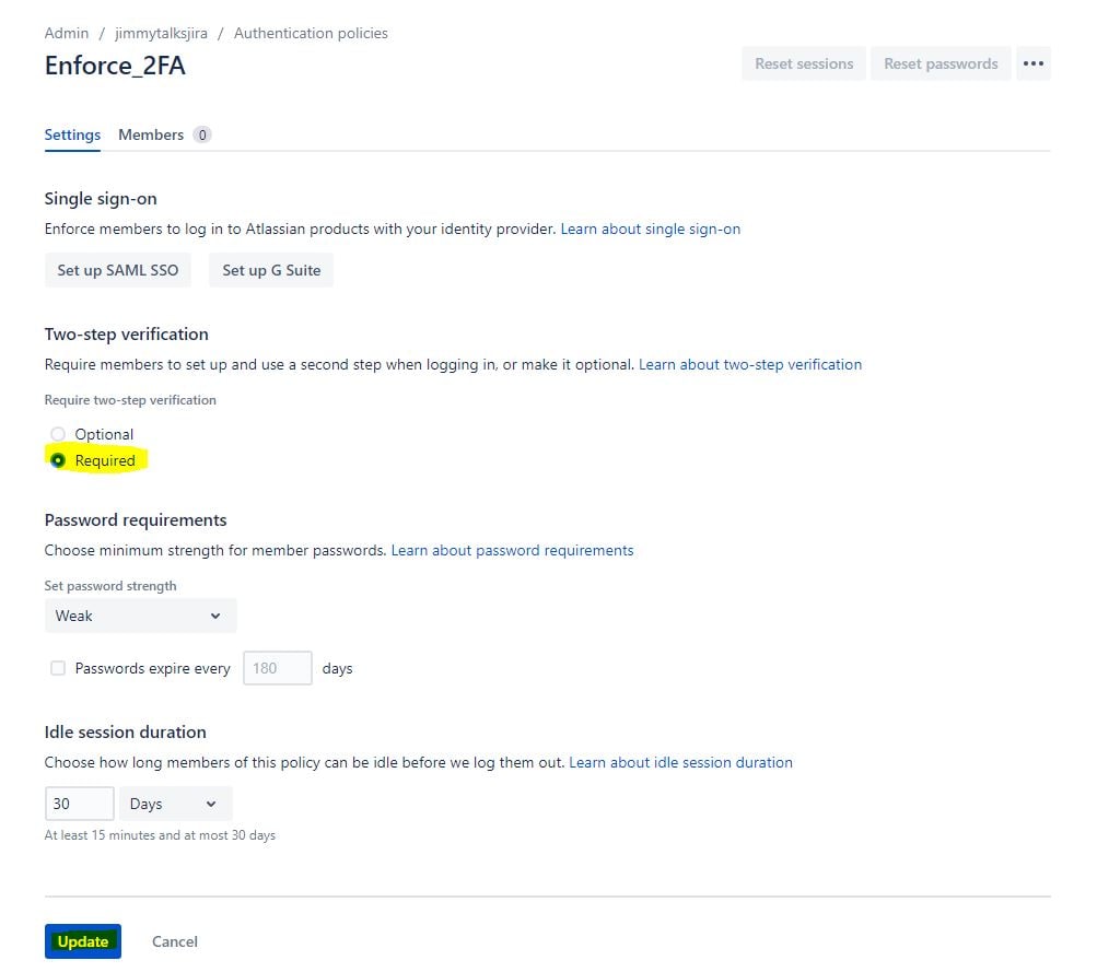

  5. In the policy screen make sure to change the “require two-step verification“ radio button to “Required“. The, click the “Update“ button.

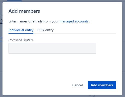

  6. Change to the “Members“ tab and click the “Add members“ button.
  7. In the popup, you can either add individual users (up to 20 at a time) or you can upload a *.csv file of email addressed (up to 1000 at a time), to add managed users to this policy.
  8. Once you are done adding members, click the “Add members“ button.

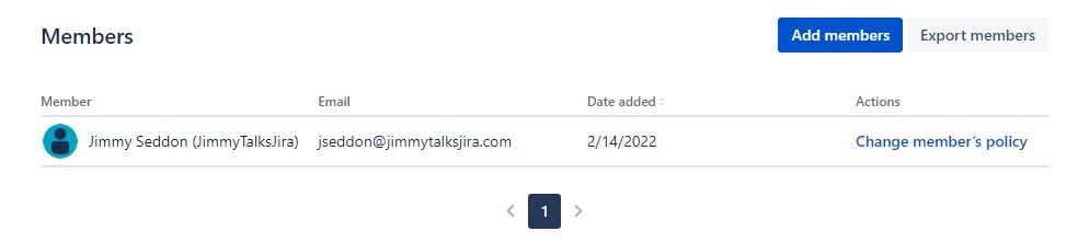

  5. Change to the “Members“ tab and click the “Add members“ button.
  6. In the popup, you can either add individual users (up to 20 at a time) or you can upload a *.csv file of email addressed (up to 1000 at a time), to add managed users to this policy.
  7. Once you are done adding members, click the “Add members“ button.
  8. Alternatively, you can select the policy we created in the Enabling Two Factor Authentication section, and click on the “Members“ tab.

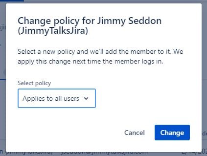

  9. Click the “Change member’s policy“ link for the user you which to switch (this is only recommended if you have a small number of users to change).
  10. In the popup, select the new desired policy and click the “Change“ button.
  11. The user will have been move to the newly selected policy.
