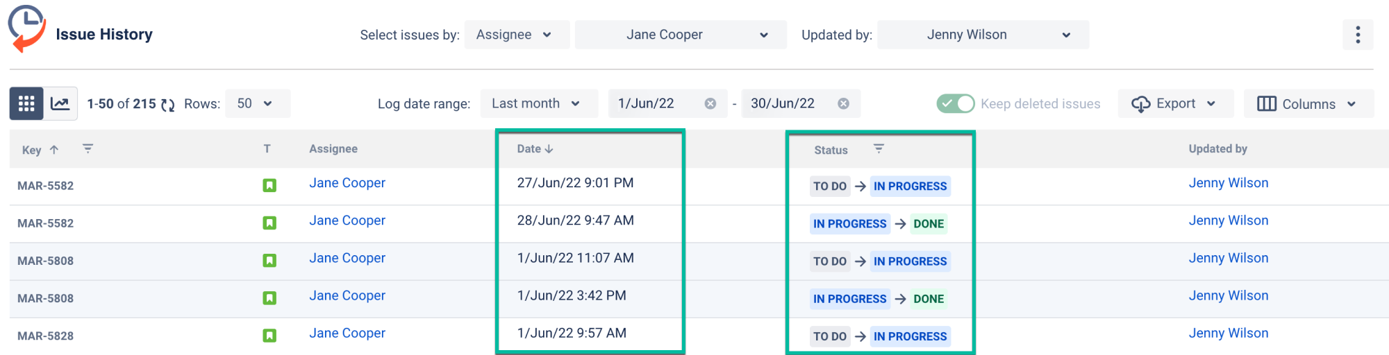

How to get Status Entrance Date using Issue History for Jira?
Issue History for Jira is a diary for every activity. It captures all changes at the issue level in chronological order.
To get the date when an issue entered some status, you need:
- Filter issues by Project, Assignee, Sprint, Label, etc.
- Choose the date range if required.
- Add custom and standard fields to the grid using the ‘Columns’ menu.
What other advantages you will get from Issue History for Jira plugin:
- Organize any kind of historical report;
- Search history activities without JQL;
- Export issue history;
- Track and store deleted Jira issues.
