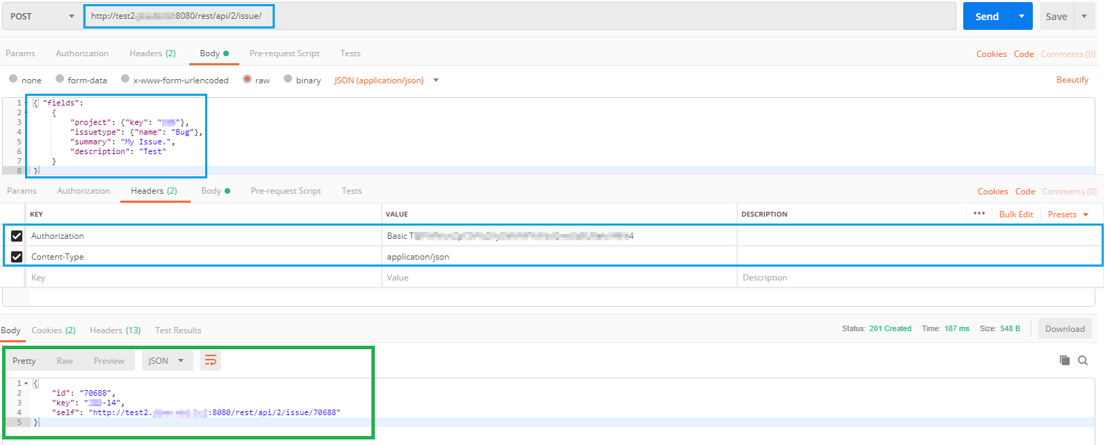

I'm trying to post a simple REST API call (hard-coded issue creation) to a test instance via Script Runner. The call should actually happen in a Script Listener but for debugging I'm using the Script Console. Unfortunately I'm stuck with a HTTP 400 response althought the call is successful using Postman.

In Postman it works:
