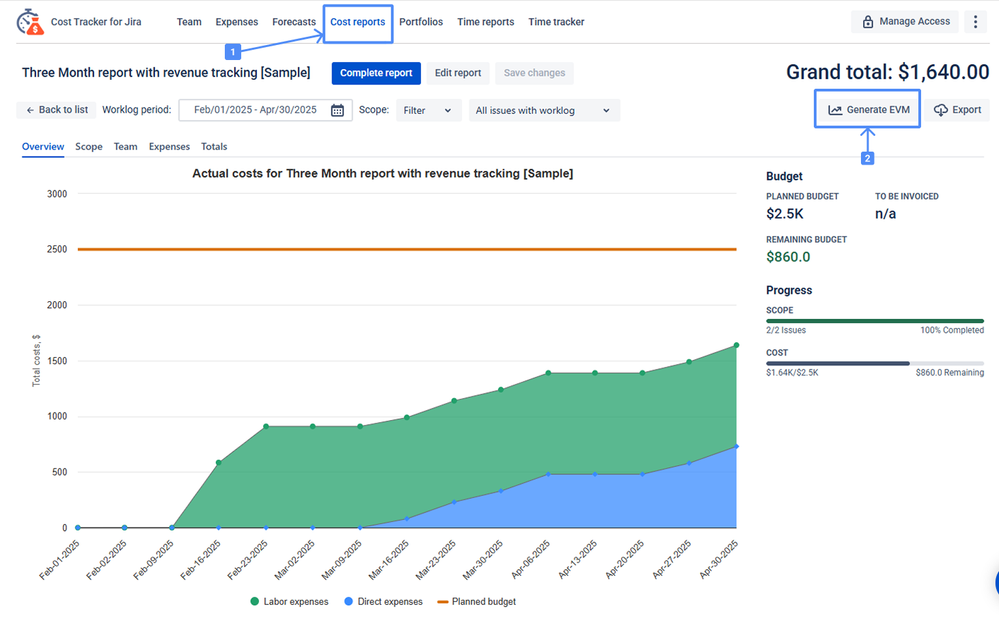

  1. Data Foundation: Meticulously log work hours, expenses, and set accurate team member rates within your Cost Tracker.
  2. Report Generation: Create detailed cost reports with the desired filters (project, date range, etc.).Group 9.png

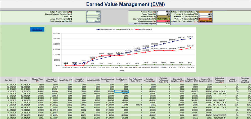

  3. EVM Export: With a single click, export your report into a pre-formatted EVM Excel template.
  4. In-Depth Analysis: Delve into the populated Excel template, revealing critical EVM metrics.image (12).png
Key EVM Metrics and Their Significance
  • Planned Value (PV): Projected cost of work scheduled for a specific period.
  • Earned Value (EV): The value of work actually completed within a period.
  • Actual Cost (AC): The real cost incurred during a period.
  • Cost Variance (CV): (EV - AC). Positive CV means under budget, negative CV means over budget.
  • Cost Performance Index (CPI): (EV / AC). CPI > 1 is good (under budget), CPI < 1 is concerning (over budget).
  • Schedule Variance (SV): (EV - PV). Positive SV means ahead of schedule, negative SV means behind.
  • Schedule Performance Index (SPI): (EV / PV). SPI > 1 is good (ahead), SPI < 1 is concerning (behind).
  • Estimate at Completion (EAC): Forecast of total project cost based on current data.
