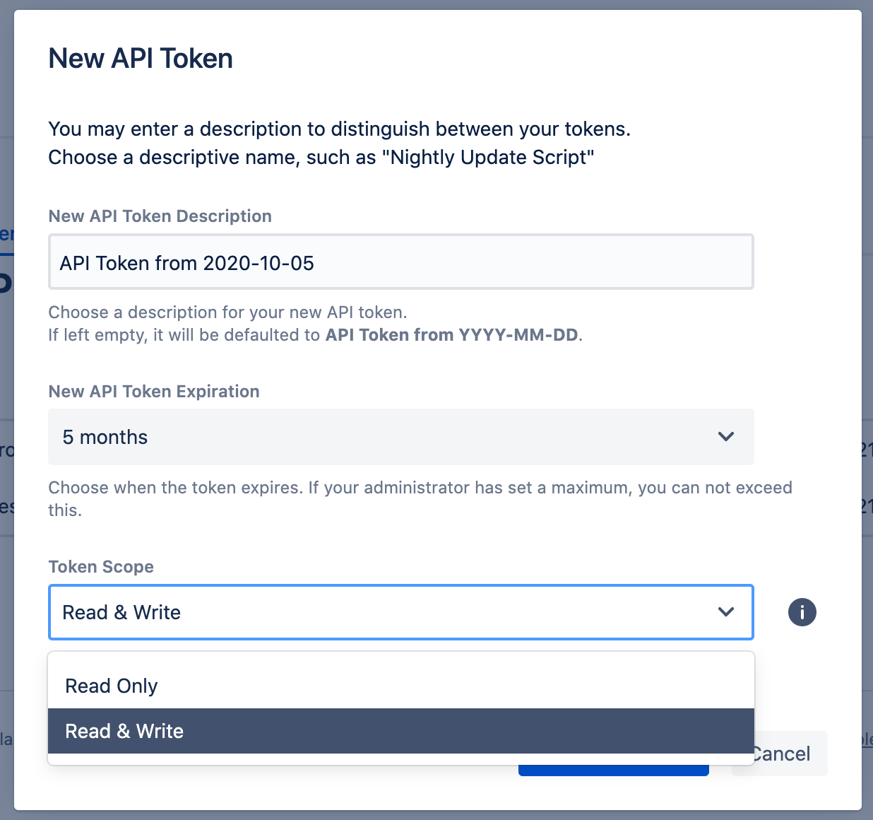

We have built scopes into our very young API Token Authentication app for Jira and Confluence for you: they will make token-based authentication an even more secure alternative to the use of passwords.
How does it work? We have decided to keep it dead simple.
Just choose whether a token can be used for any API method, or only to read from the database.
If you’ve ever interacted with an OAuth flow I’m sure that you’re perfectly aware of how central the notion of token scoping is for delegating authorization to third-party apps.
We’re essentially talking about the same function – but instead of OAuth, token scopes will let you specify which methods can be used in API calls using the Jira Server REST API or the Confluence Server REST API.
This scope should be used for scripts and connections that only need to take information from Jira and share it somewhere else.
Sometimes it can be a good idea to stop non-technical users from tampering with Jira and Confluence data by allowing them to create only tokens with this scope. Read the section on Forcing regular users to create read-only tokens below to learn how to do this.
Notifications and reports are the best example of what you can do with read-only tokens.
However, some simple integrations may also benefit from this. For example, if you want to automate the creation of new cards in the Trello boards that you use with freelance designers whenever a design-type issue is created in Jira.
All methods are supported in Read/Write tokens. Specifically, this means that all the DELETE, POST, and PUT endpoints in the REST APIs can be called in addition to the list above.
This scope should be used only for any scripts, integrations or connections with a business logic intended to improve, change or somehow enhance how your Jira (or Confluence) works.
You may be interested in enabling only by folks with a sufficient understanding of 1) how your processes are currently run 2) what could make them better and 3) how APIs are built, for example being able to tell the difference between the PUT and POST methods.
If that’s the case, you can resort to the app’s permission schemes so that only power users can create read/write tokens, either for themselves or for others. More on that later.
The possibilities here are endless, so I’ll just mention some of the actions that are possible with the ability to change data in Jira:
Edit a filter for a JQL search to get exactly the issues you need to work with
Since 1.5.0, the decision to apply one scope versus the other has to be taken every time a new token is created.
Scopes are applied per token, not per user. However, we have included an option to restrict who can create read/write tokens.
To apply it, navigate to the Permissions tab in the app configuration, then select the box Users may only create "Read Only" tokens.
When the option is activated, only the users with the permission to create tokens on behalf of other users will be able to select the read/write scope when creating a token (either for them or for somebody else).
