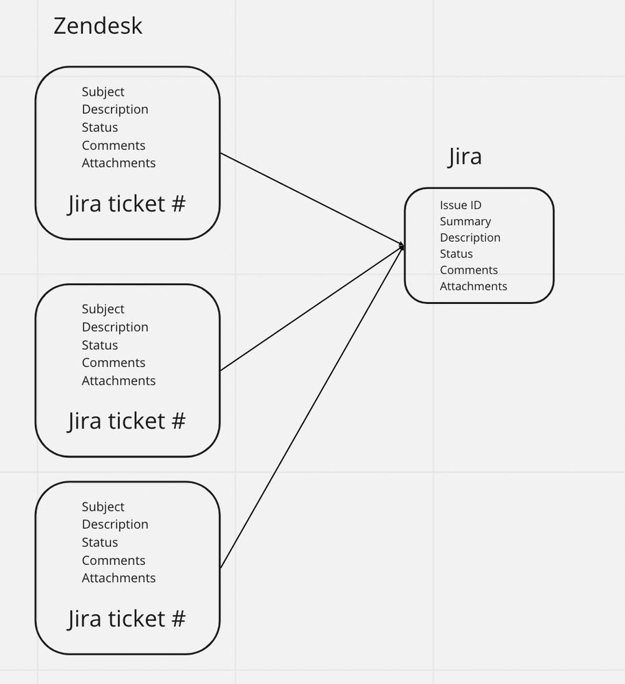

A customer wanted to sync multiple Zendesk tickets (raised by their customers) to be reflected in a single Jira Cloud issue to be taken up by the Dev team.
Also, once the status on the Jira issue has been marked as “Done” from “In Progress”, the corresponding status on the Zendesk side would be changed to “Open” from “New”.
A custom field called “Jira ticket #” is used as an identifier to the issue on the Jira side.
Summary/ Subject, description, labels/ tags, attachments and comments need to be synced bi-directionally between the 2 systems.

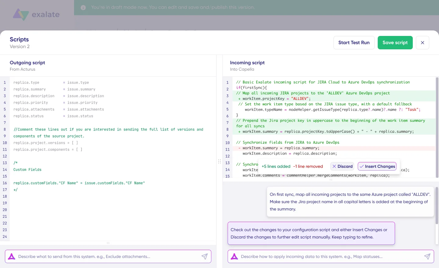

Configuration of the Sync Rules
As stated above, we need to configure both the incoming and outgoing information at either end using Sync rules.
Starting with:
Zendesk: Outgoing Configuration
The ticket information from Zendesk like summary, description, labels, etc to be sent to Jira are present in the “Outgoing Sync” by default.
To this, I add only the information from the custom field “Jira Ticket #”  to be sent over to Jira.
Zendesk: Incoming Configuration
Since I need to map the statuses between Jira and Zendesk, the mapping code needs to be added in the “Incoming sync” on Zendesk. Remote and local statuses are mapped one-on-one.
Also once the issue has been marked ‘Done’ in Jira, a comment is added on the Zendesk ticket stating “Fix has been released by Dev team”. This is done using the commentHelper class of Exalate.
Jira: Outgoing Configuration
Nothing specific needs to be added to the “Outgoing sync” of Jira, so the default configuration remains.
Jira: Incoming Configuration
For this, when the ticket is synced over for the first time, it needs to create an issue in the specific project, in our case “AAA” is the project that is selected.
  • Then depending on the remote issue, an issue type is set, default is Task if no issue type is found.
  • The Jira issue ID from the Zendesk custom field “Jira Ticket #” is saved in the remoteIssueUrn variable
  • Simply fetch the Jira issue details using the httpClient.get() method in the localIssue variable.
  • If the Jira issue is not found, then an “Issue not found” exception is raised.
  • However, if the Jira issue exists, then simply set the Jira issue ID to the localIssue ID.
  • Summary, description, comments, attachments, and labels are synced as is.

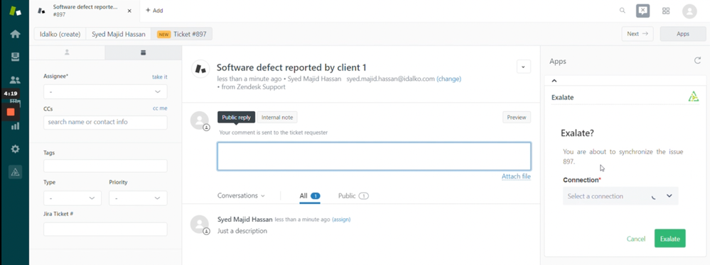

We create a ticket on the Zendesk side and sync it manually to the Jira side by clicking the Exalate button on the right panel of the ticket view. Though this can be done automatically with the help of Triggers.

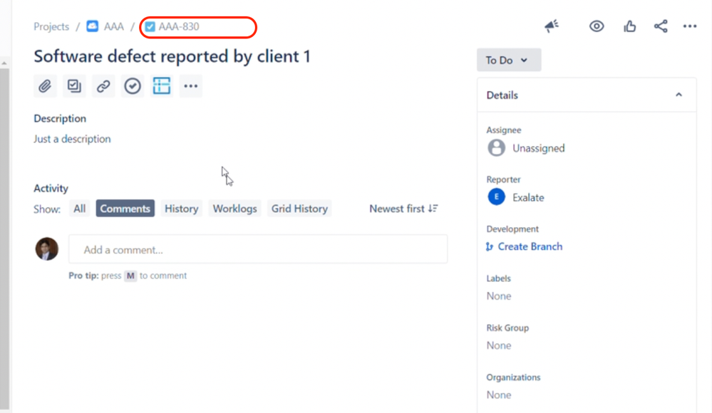

The issue on the Jira side has the ID: AAA:830
Remember this is the ID that needs to be entered on the Zendesk side.

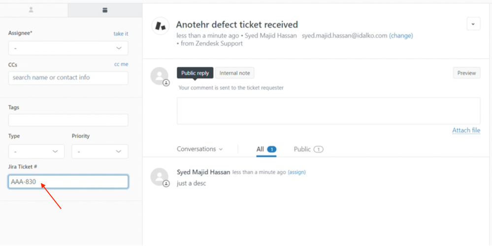

So when a new ticket is created, the same ID is entered in the custom field “Jira ticket #”.
And when it is synchronized, it gets synced to the same Jira issue we have entered.
