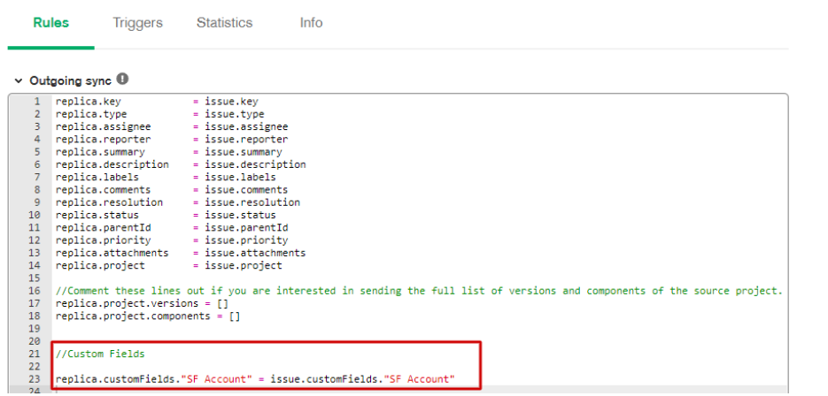

Under the “Rules” tab, enter the following code snippet into the “Outgoing sync” text area.
replica.customFields."SF Account" = issue.customFields."SF Account"
Note: The issue.customFields function points to the custom field name within the Jira issue. The replica works as a payload or a message. It contains information you want to pass between the two systems.
Once done, click “Publish” to save the changes.

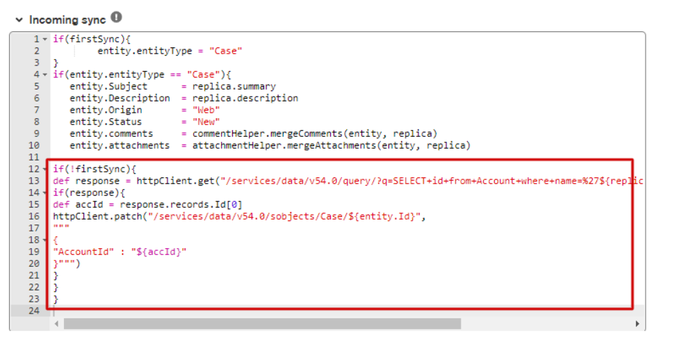

if(!firstSync){
def response = httpClient.get("/services/data/v54.0/query/?q=SELECT+id+from+Account+where+name=%27${replica.customFields.'SF Account'.value}%27")
if(response){
def accId = response.records.Id[0]
httpClient.patch("/services/data/v54.0/sobjects/Case/${entity.Id}",
"""{"AccountId" : "${accId}"}""")
We use the httpClient method to fetch (GET and PATCH) the correct account name selected in Jira and save it in a response variable. Then the case in Salesforce is updated with the particular account information.

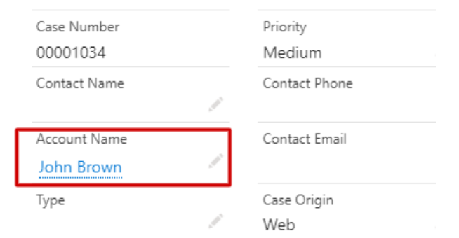

Now go back to the JIRA issue and change the SF Account to one of the options.
Back on Salesforce, you will see the Account Name appear automatically.
On the Salesforce side, enter the code in the “Incoming sync” text area.
