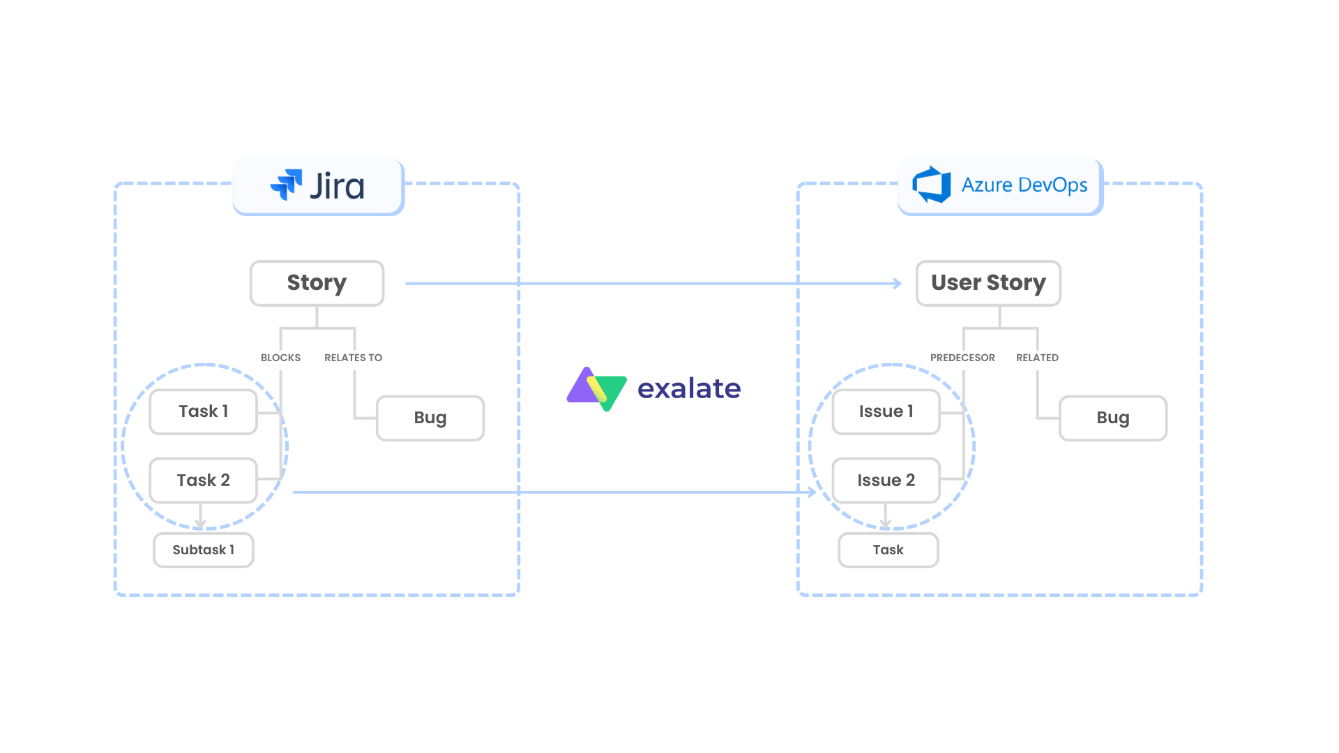

The Use Case
The following are the use case requirements:
- Stories in Jira should arrive as a User Stories (work item) in Azure DevOps.
- Stories have issue links: Tasks and Bugs. These need to be reflected in Azure DevOps under the corresponding User Story as issues and Bugs.
- Tasks have a “blocks” relationship type with the Story. They must be synced over as issues with a “predecessor” relation to the User Story in Azure DevOps.
- Bugs in Jira have a “relates to” relationship with the Story. They should be reflected as bugs work item type with a relation “related” to the User Story in Azure DevOps.
- Sub-tasks of Tasks in Jira are to be mapped to Tasks (as a child relationship) under the corresponding issues in Azure DevOps.
A visual depiction of the use case will make things clearer.

- Syncing a Story in Jira to User Story in Azure DevOps
Tasks in Jira fly as issues in Azure DevOps. Bugs are to be kept as Bugs. Maintaining these mappings is important.
- Mapping of the parent-child relationship between the sub-tasks and Tasks in Jira to Tasks and issues in Azure DevOps
- Customizing the relationship types fully
You can define and map them as you want. For instance, the “blocks” relationship type is mapped to “predecessor” in Azure DevOps. Or the “relates to” relationship type is mapped as “related” in Azure DevOps. These are just examples, the actual mappings will depend on your synchronization requirements.

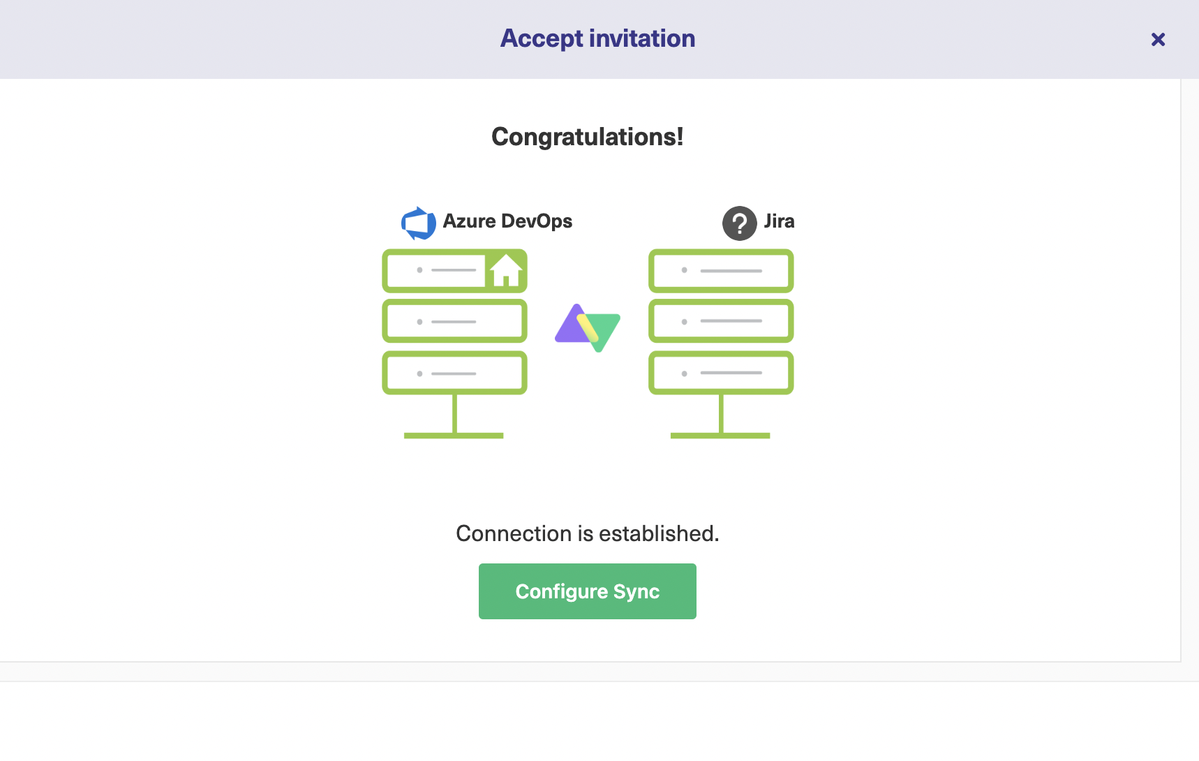

Start by installing Exalate on the integrating systems, Jira and Azure DevOps in our case.
Then you can establish a connection between the 2 instances in the Script Mode.
You can also find a step-by-step guide on how to do that.
The Script mode has Groovy-based scripts in the form of “Incoming sync” and “Outgoing sync”.
When a connection is established, click on the “Configure Sync” button or edit the connection to access the “Rules” tab. This is where the syncs we just talked about reside.

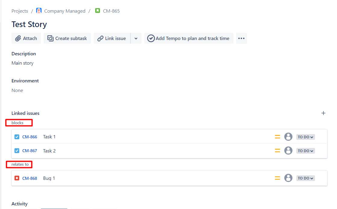

You can set up automatic sync triggers to start the sync whenever a Story is created in Jira.
In Jira
- Create a story in Jira.
- Create the issue links
- Create 2 tasks: Task 1 and Task 2 with the required relationship types.
- Create a bug with the required relationship type.

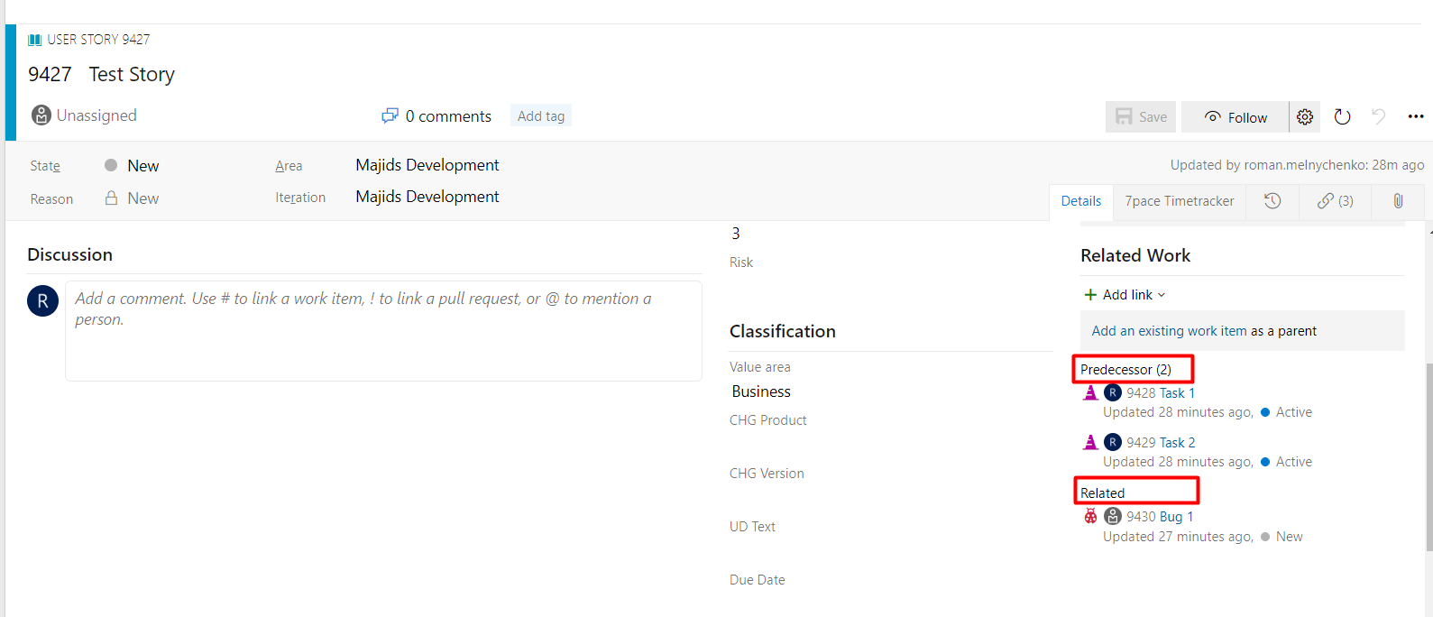

In Azure DevOps
Work items and the relations are synced and the parent-child hierarchy is maintained.
