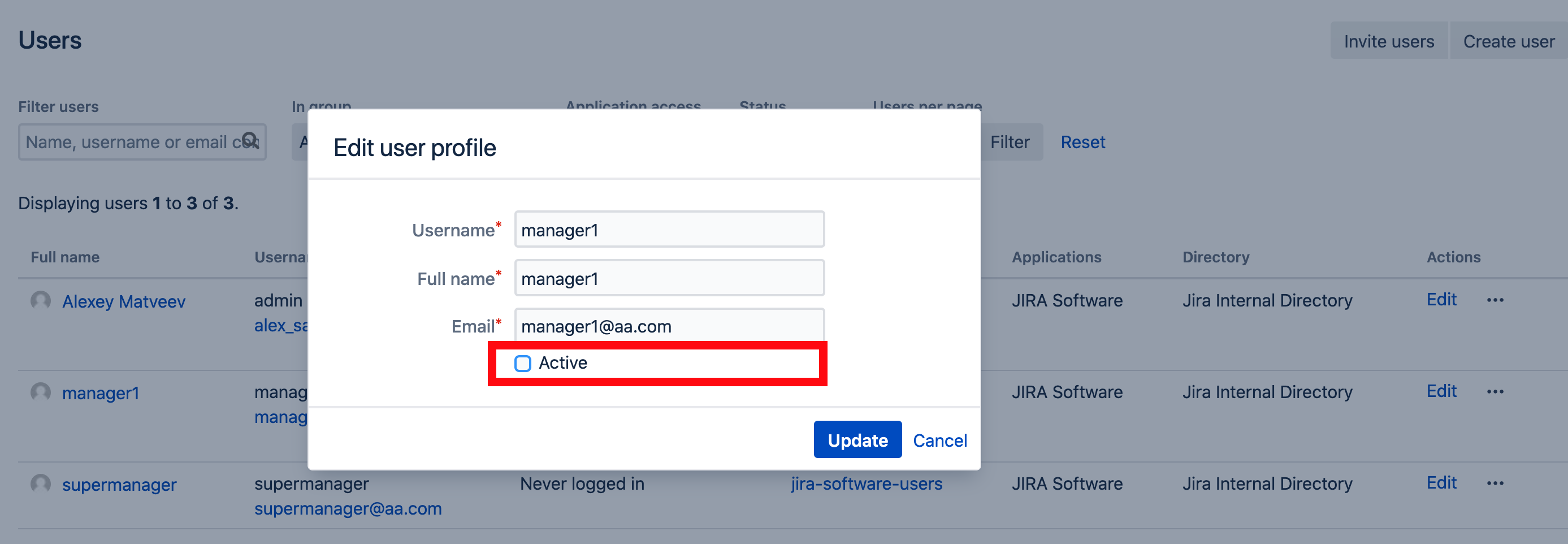

Let's check how it works. Open the User Management Jira settings and deactive the manager1 user:

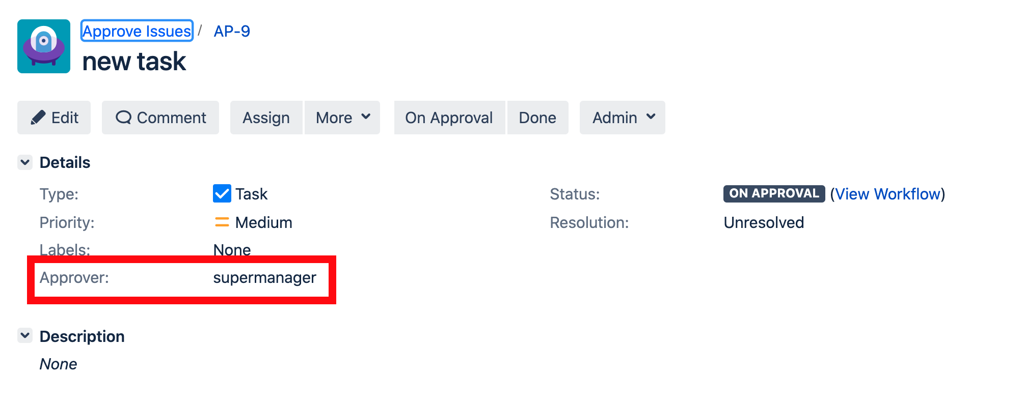

Click the Update button and let's open one of our created issues:
It worked!
