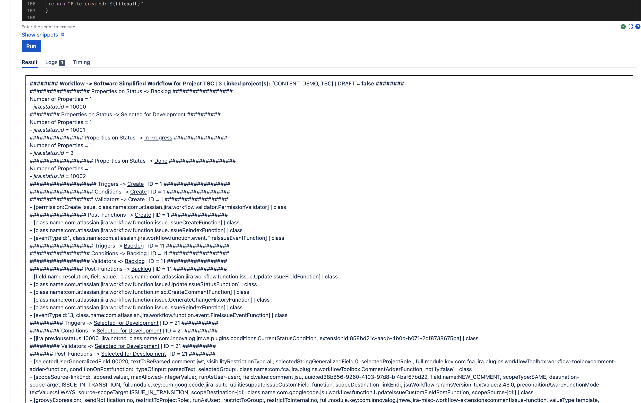

After running the script, you will able to collect an html file (or to see it in the result console), with all detailed informations on active workflows. By searching for apps package or keys (jsu, jmwe, jwt… for example) you will be able to see all apps usages, on which transition or status, for each active workflows.

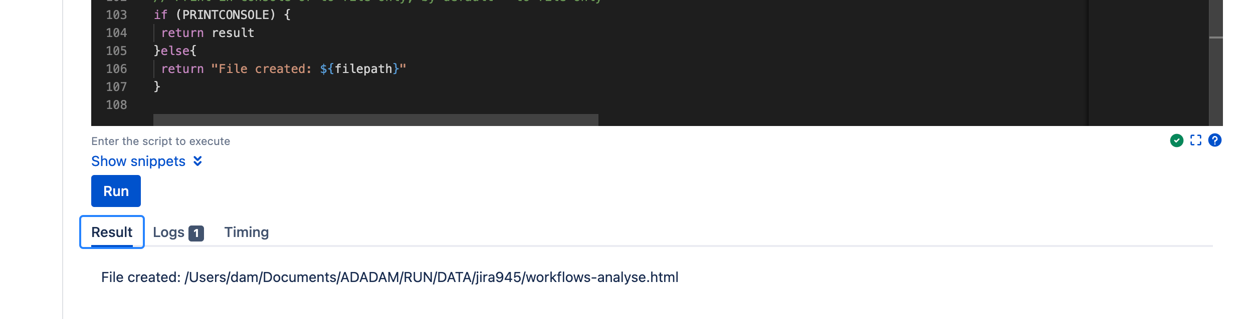

To print the results in ScriptRunner results console, just change the boolean value of the variable PRINTCONSOLE to true:
// Results as file or print in result console
// Change value to true to print in console
Boolean PRINTCONSOLE = false //true
ℹ️ Keep in mind that results displayed in ScriptRunner results console can be truncated as there is a limit on the number of character that can be showed in the results console of the app. If you have a large number of active workflows, it’s much better to collect the file to be able to see all results.
For one active workflow, the generation of the html file will be done in less a second, for 100 actives workflows, the html file is generated in less than 2 minutes.
Using the html file generated from the script, you can now start to analyse your apps usage, count for keys and packages, focus on the most used workflows. It’s also very helpful to clean up workflows on your server/datacenter platform in order to ease the whole migration process to the Atlassian Cloud.
