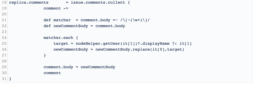

With the groovy based scripting engine, it is pretty straightforward to have it done
  • Line 18 - iterate over all the issue comments
  • Line 21 - RegEx which collects all the mentions in the comment body
    A mention is stored as [~<userid>]
  • Line 24 - Iterate over all the mentions found in the body
  • Line 25 - Look up the mentioned user object using the nodeHelper.getUser
    • If the user is found, set target to display name
    • if the user is not found, set target to the userid of the user
  • Line 26 - Replace all the mentions for this specific user to the constructed target
  • Line 29 - Assign the new comment body to the comment
(The code snippet above can be found here)

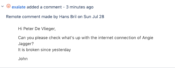

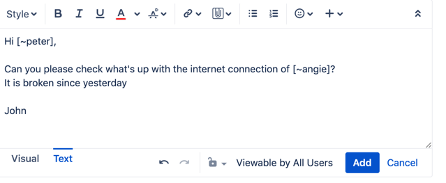

Now whenever someone creates a comment on the source like following message
The piece of groovy code will replace the mentions of Peter and Angie with their Full Name, and send this over to the other side, resulting in
