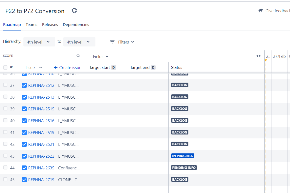

We are using Jira Server and we have Advance Roadmap v8.18.1.

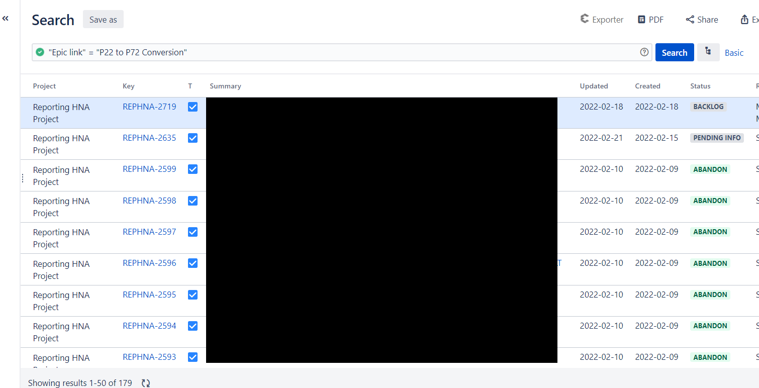

I have created yesterday a roadmap based on a filter and there are some issue that don't appear in the roadmap. In the filter are 179 issues and in the roadmap only 45.
I have notice that all the tickets in the status "Abandon" and "Resolved" do not show plus User stories ( there are only 2).

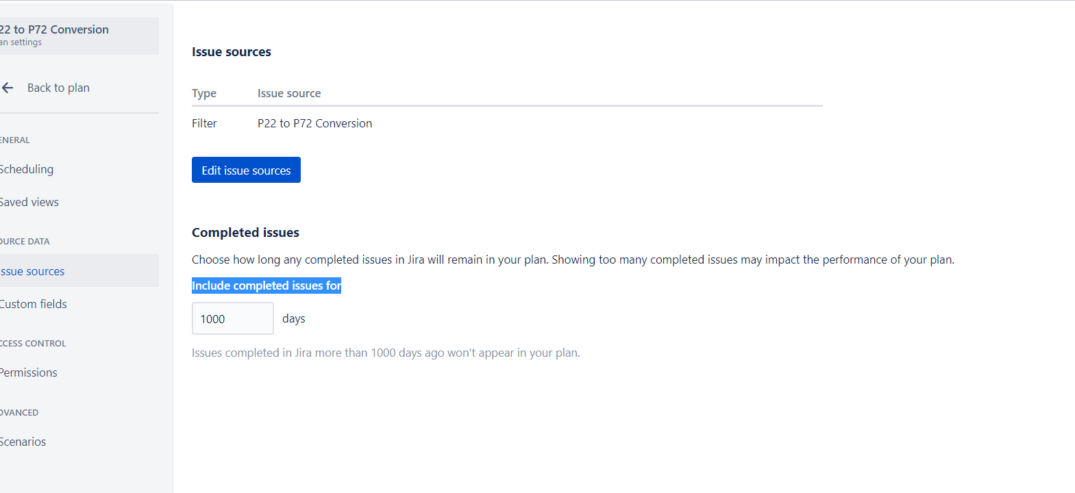

I have increased the "Include completed issues for" to 1000 but doesn't make a different.
I have attached print screens with evidence.
Could you please support for this issue?
Best regards,

@Andreea Andrei Can you try clicking on the filter and see what options are available for Status?
Andreea Andrei
February 25, 2022
Hi @AMIT GULATI
I looked on that before and there is nothing checked:
