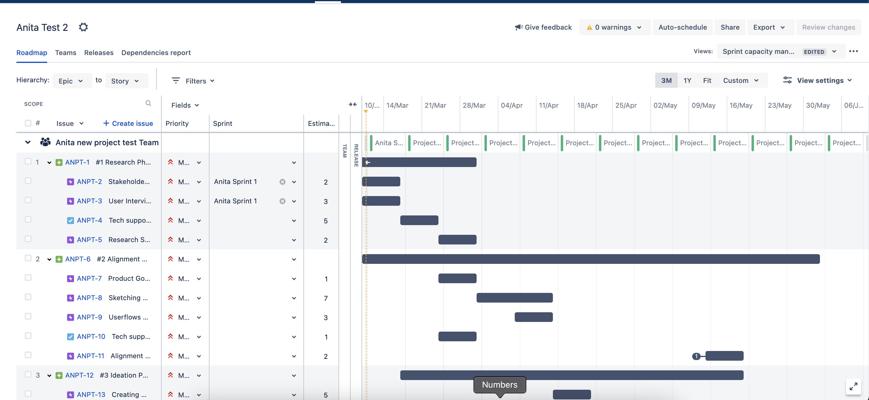

I have created a plan with following setup:
  • issues grouped in epics
  • added estimates and team
  • created team with 1 week iteration length and 37,5h capacity
  • used only one dependency
I have turned on sprint capacity view and used auto-schedule, as a result I have a plan that looks like this:

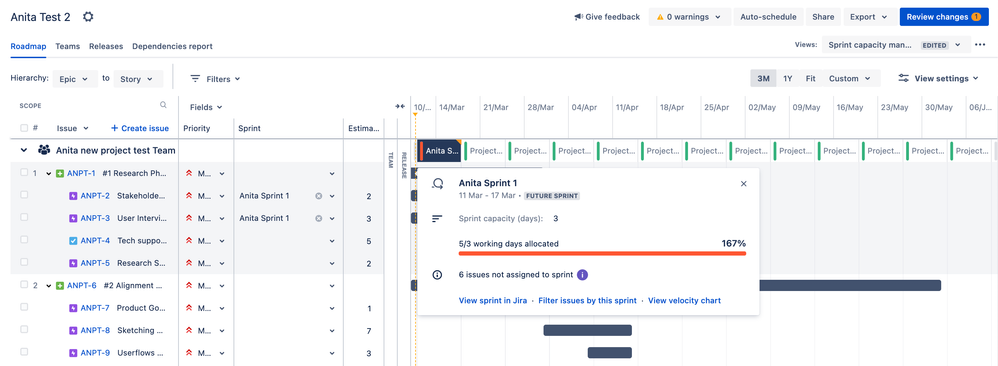

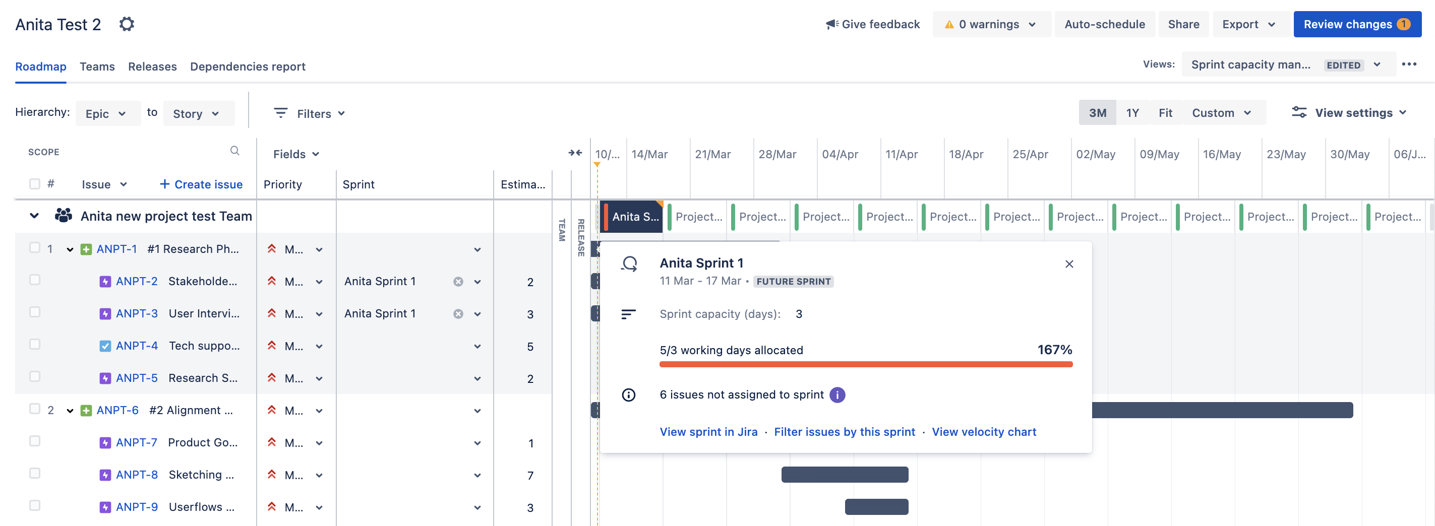

I wanted to try out manage sprint capacity option that was described here so I changed it for Sprint 1 to be 3 days instead of default 5.

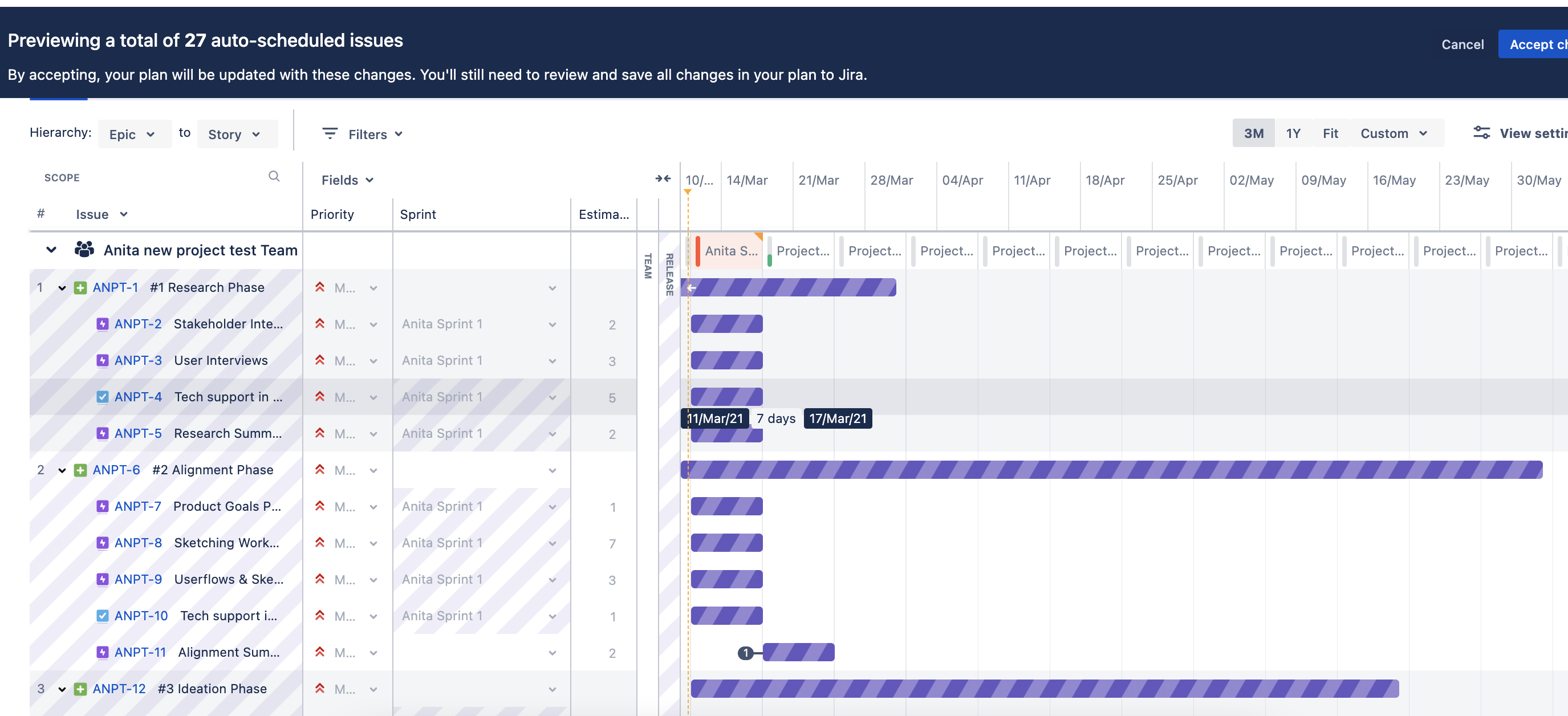

By clicking on Auto-schedule I would expect work that is currently in sprint 1 to be moved to the following sprints. What actually happened is that all work is assigned to Sprint 1 and it gets even more overbooked.

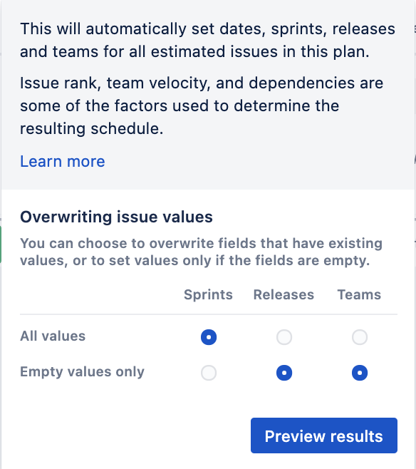

This are the options I used on Auto-schedule:

Hi @Anita Cacic ,
Thanks for raising this question.... we've had a quick investigation and it seems like this is a bug. It does work as expected for story point estimation but not for time based estimation. We're going to do some further investigation and verify where the problem is and resolve this issue. We really appreciate you bringing this to our attention and are very sorry for the inconvenience that this is causing!

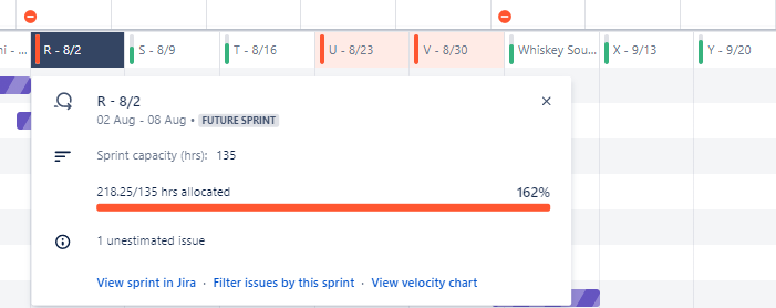

When auto-scheduling the work, several sprints end up overbooked:

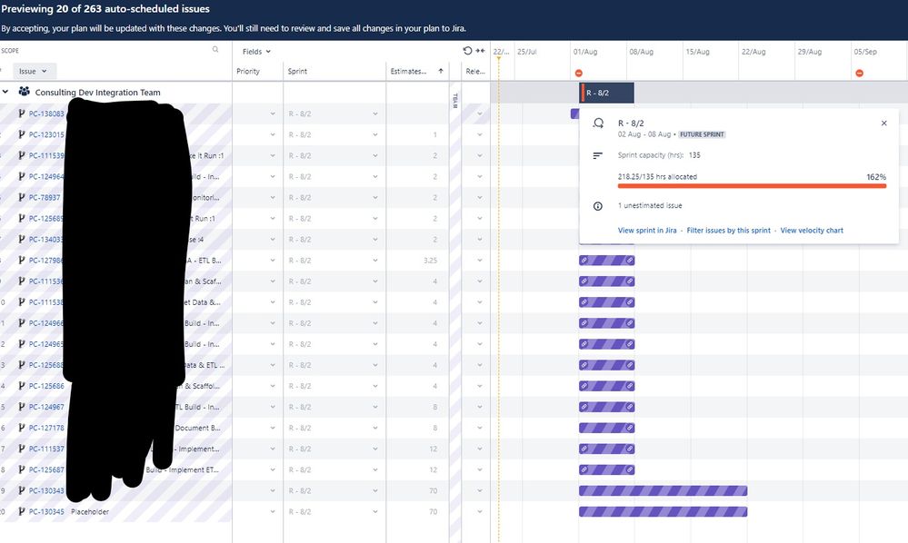

I've tried (1) clearing all dates + sprints and then (2) hitting auto-schedule again to see if that would help, but it yields the same results: overbooked sprints.
When filtering down to see the issues listed for the sprint, it looks like the full value of each 70 hour item auto-scheduled is being added into the total for the given sprint (R in this case), despite being shown as spread across 3 sprints (R, S, and T).
To me, I see 2 issues here:
  1. The sprint is being overbooked by 83 hours by the autoscheduler
  2. The item on the "fringe" (i.e., next in priority, but valued at more hours than available) isn't being split across sprints capacity-wise as a user would expect given your documentation
For issue #1 -- looking at the screenshot, I would expect 1 of those 70hr items at the bottom to be pushed to a later sprint since it definitely doesn't fit in the sprint given the capacity available (pushing the last 70hr item to the next sprint would take us from being 83hrs over to 13hrs overbooked).
For issue #2 -- let's imagine that my expectation in the last bullet was true. This would take us from 83 hours over capacity to 13 hours over capacity in this scenario, which means the other 70hr item (the one that we can partially keep in the sprint) would be split 57hrs in sprint R; 13hrs in the next sprint.

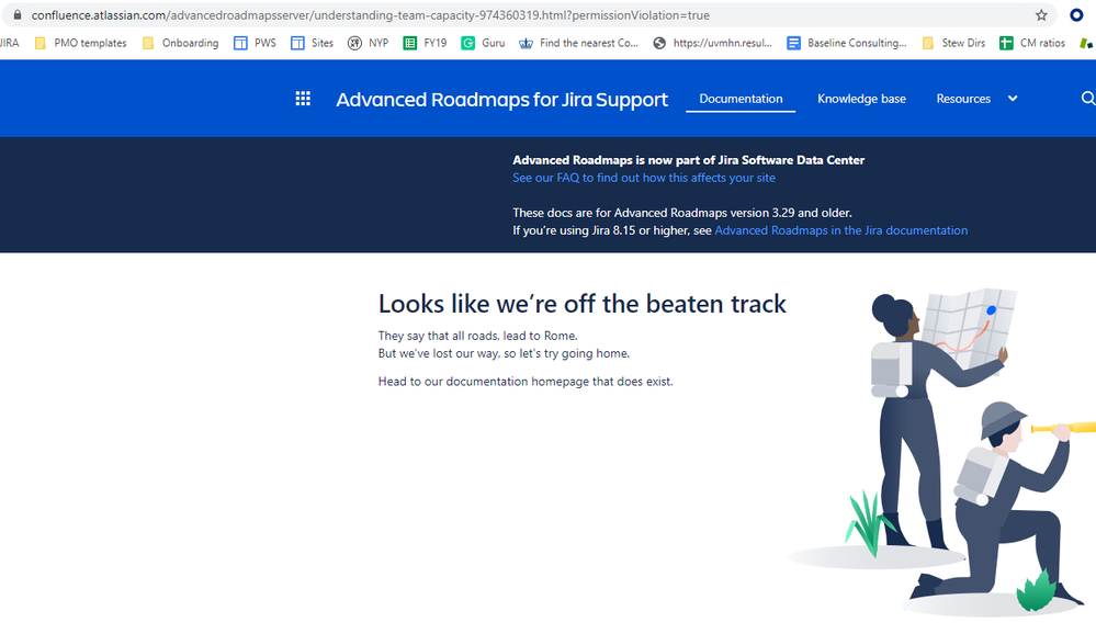

I tried to follow the link in one of the subsequent bullets in your documentation about understanding capacity, but it appears to be a broken/forbidden link.
  • You can drill down in the capacity details by clicking the capacity bar of the sprint. See Understanding team capacity for more details. Note that the precise allocation of capacity (as you see in how issues are scheduled in the timeline) will not be reflected in the capacity details.
  • Screenshot I get when I try to access the page for understanding capacity:
