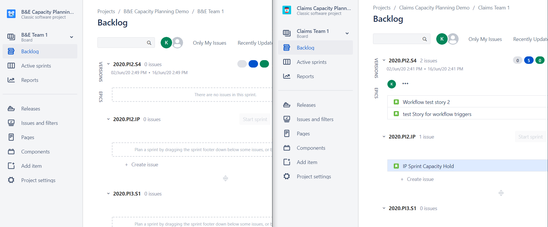

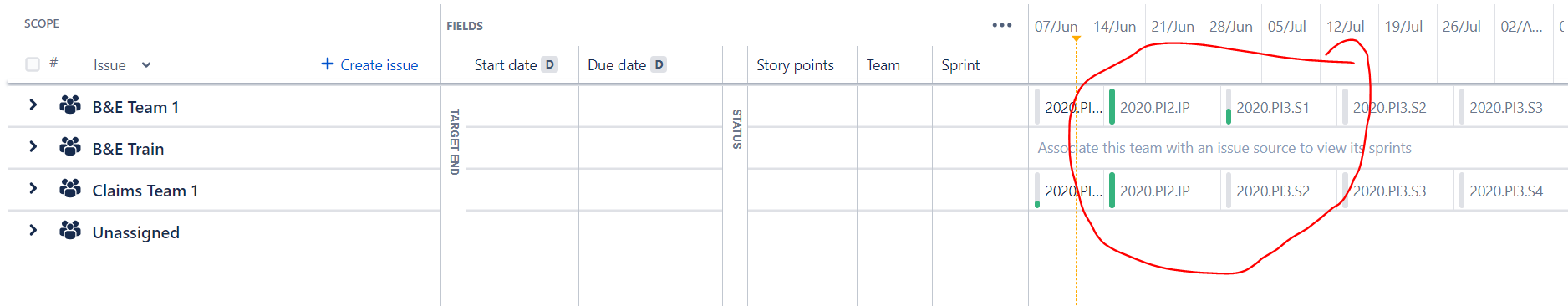

I am pulling in sprints that are aligned to the same schedule and naming convention across different projects and boards.  Aligning a single board to a single shared team. The system is successfully recognizing that the sprints of the same name from the different boards are intended to be executed in the same time period.  However, the plan is shifting the sprints that were created on the board backlogs out of order, and then issuing a warning that they do not have the same dates.
I have tried to re-define the sprints, but the tool started doing strange things in the plan like creating duplicate sprints. Then instead of re-defining / renaming sprints, I deleted and started over building out the sprints.  Still the same problem.
I have included attachments that show two different boards for two different teams. These teams have the same active sprint with the same start and end date.  Both of these boards/teams have the same sprints built out in the same order in their backlogs. However, the plan has shifted the sprints out of order. Both Backlogs and Sprint Build Out.PNG Plan with Sprint Missing.PNG

Just catching up with this thread as I got notified by the recent post from @Olga Plisko ...
To give some context around this it's important to understand that sprints are not tied to any specific board. If an issue on a board is assigned to a sprint then that sprint will appear on the board (so sprints can actually appear in multiple boards).
On more recent versions of Server / Data Center it is possible to configure the start and end dates of future sprints (this capability isn't available on Cloud yet) but typically only active and completed sprints have start and end dates.
When you include a board as an issue source in an Advanced Roadmaps plan it will bring in all the sprints that are associated with that board. Active and completed sprints will be rendered on the timeline using the dates that they have, but all future and projected sprints will be rendered based on their order on the board and the iteration length configured for the issue source.
A future sprint is any sprint that exists on the board that is neither completed nor started and a projected sprint is a sprint that is expected to be created based on the iteration length.
Due to the absence of guaranteed start and end dates on a sprint this can result in sprints appearing in unexpected positions on the timeline. This often occurs when an issue is assigned to a team that is not associated with the issue source from which the sprint assigned to the issue is derived.
You can also get duplicate future sprints appearing (sometimes with different lengths) in this case too - especially if the sprint is assigned to issues for different teams with different sprint lengths.
We'd typically recommend that you try to organise your work so that each team has it's own dedicated board (you can do this by sharing the team and using it in the JQL filter used for the board source and then using that board as an issue source that you associate with the team).
We're actually investigating making this much simpler - ideally, the iteration length and team associated with the issue source should be configured on the issue source itself. The way that it works right now is a result of the Advanced Roadmaps previously being a 3rd party application.
Hopefully this explains some of the behaviour that is happening. Please let me know if anyone needs any further clarifications or if it feels like their is a bug that needs addressing (although in the case of a bug it might be more efficient to log a support case).
