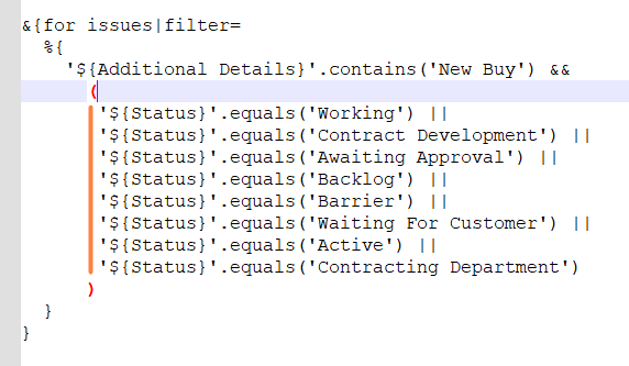

@Rogério Paiva - Xray Xporter I don't know what my SEN is and I'm not an administrator, just a Project Lead for my project.  Would you be able to take a look and see if you notice why I'm having problems?  The code snippet I use is this:
&{for issues|filter=%{'${Additional Details}'.contains('New Buy')&&'${Status}'.equals('Working')||'${Status}'.equals('Contract Development')||'${Status}'.equals('Awaiting Approval')||'${Status}'.equals('Backlog')||'${Status}'.equals('Barrier')||'${Status}'.equals('Waiting For Customer')||'${Status}'.equals('Active')||'${Status}'.equals('Contracting Department')}}
I would expect only issues that have "New Buy" listed in the Additional Details field would populate (which have any of the corresponding Statuses listed).  But what ends up happening is that some issues are populated that do not have "New Buy" listed in the Additional Details field.  Basically I'm only trying to pull those issues with "New Buy" listed with any of the Statuses present in the code.
Thanks for the help!

Hi @Kurt Willrich
Yes, indeed, it is necessary to have the SEN (Support Entitlement Number) to have support. However, if you have an Active license (but don't know the SEN), open the ticket with a company email and provide information about the company, and we will try our best.
About your code, the OR conditions should be grouped between parenthesis to evaluate the OR conditions together. With the current condition, the AND only applies between the Additional Details and the Status "working"; it does not apply to all the other statuses.
I have expanded the code to give you an example of where the parenthesis needs to be placed:
In the template, you need to have this code in a single line.

Thanks so much @Rogério Paiva - Xray Xporter !  I’ll give it a shot to see how it works. I figured I was missing something fairly simple but just wasn’t getting there. If I have any other issues I’ll get in touch with the support team as you suggested. Thanks again!
