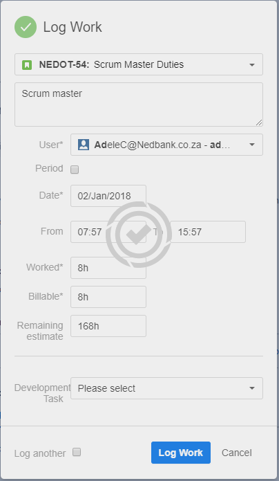

I'm trying to log work for a team and I keep getting an error message "Error! Something went wrong", and the Log Work pop-up just keeps loading non-stop.

We have the same issue. Error appears, log dialog disappears. But logging was not processed.
Strange is that it happens only for some tickets , others are o.k.
We assume that it relates to the update of Tempo plugins we made this week. We are on version 8.13.1.
Any hints for us?
Hello !
I was able to identify the reason:
the relevant tickets had "null (null) [ 0 ]" included as Account. After deletion the time logging works again.
