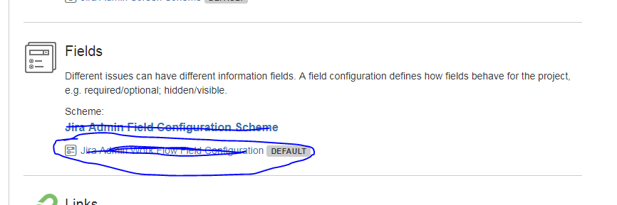

Your project would be using some Field configuration.
Go to Project's Administration, and see what that is.
