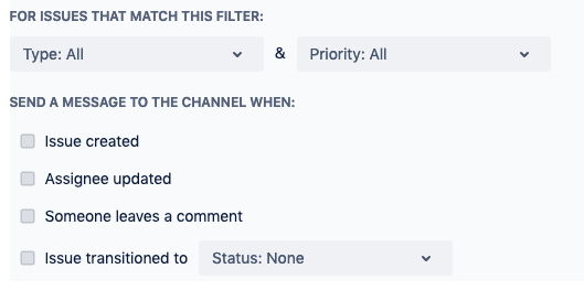

The one we've been using seems to not have the trigger actions you shown ("SEND A MESSAGE TO THE CHANNEL WHEN") although I can see the JQL advanced filter
Mine seems to be simpler:
Thanks.
Hey @Bruno Mazzoco ! Can you confirm if you're on Jira Cloud (URL looks something like <yoursite>.atlassian.net ) or Jira Server (might be something more like jira.<yourdomain>.com)?
If you're on Jira Cloud, could you let me know what your Cloud URL is? The configuration for Jira Cloud should look similar to the screenshot above, so if you are on Jira Cloud, I'd like to investigate your site as it should have updated the Slack connector itself. Thanks!

Thanks for confirming @Bruno Mazzoco . Depending on what you need to trigger on, you could use the "Issue transitioned to Status: All" option at the bottom in combination with the JQL filter to get notifications. The difference between here and Cloud is that the issue would also need to be moved between statuses before the notification is sent - just adding a fixVersion to the issue wouldn't be enough.
