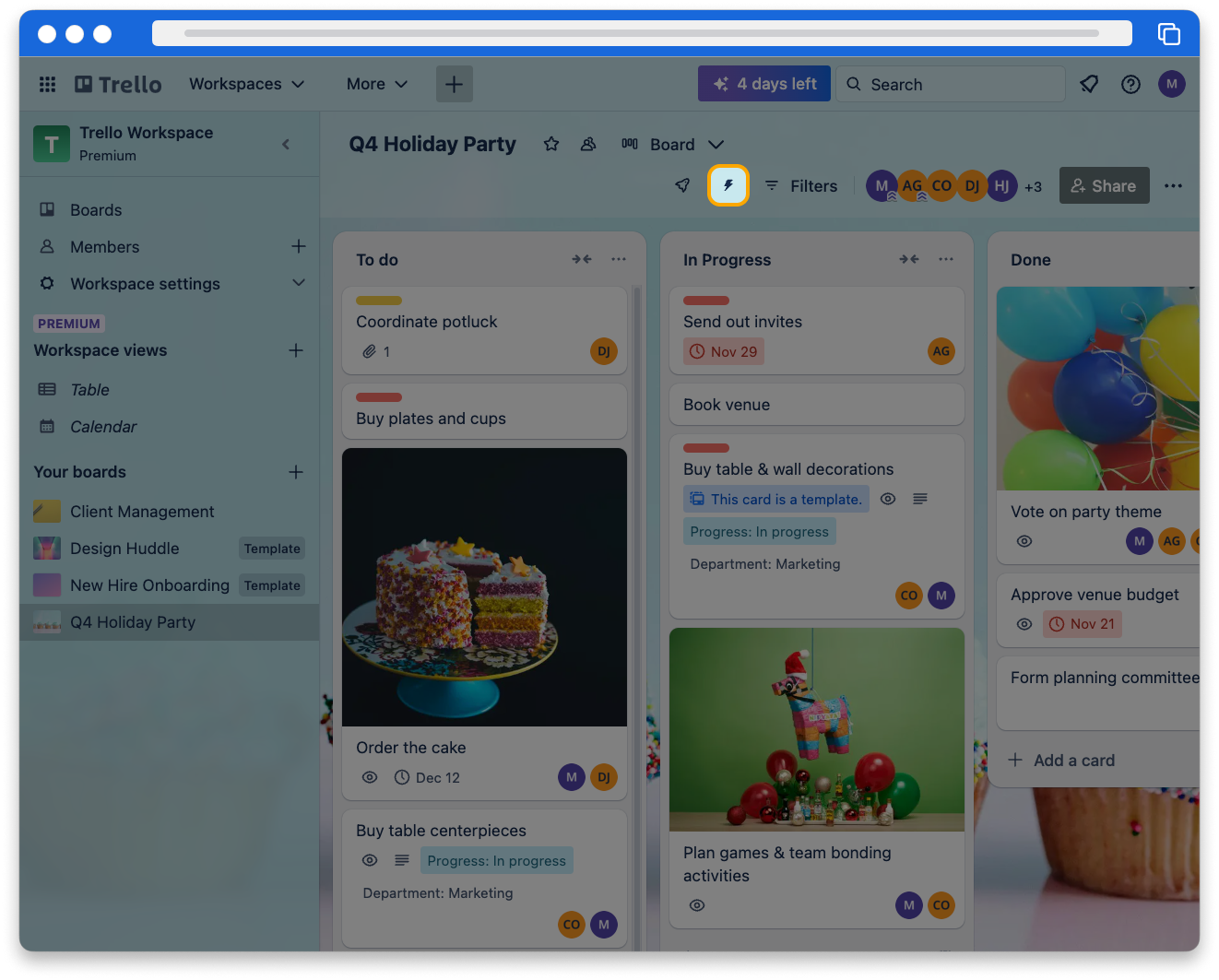

You can create and manage all your automations from the Automation directory’s automation builder, which you can access from the Automation button (indicated by a lightning bolt icon) in the top-right corner of your Trello board or from the board menu.
👇 Create and manage your automations from the Automation directory.
A screenshot of Trello board with Automation icon highlighted at the top of the board

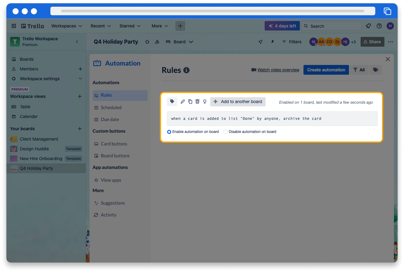

👇 In this example, the trigger is “when a card is added to list ‘Done’,” and the action is “archive the card."
A screenshot of the Rules page in board Automations. The rule “When a card is added to the list” Done” by anyone, archive the card” is highlighted.

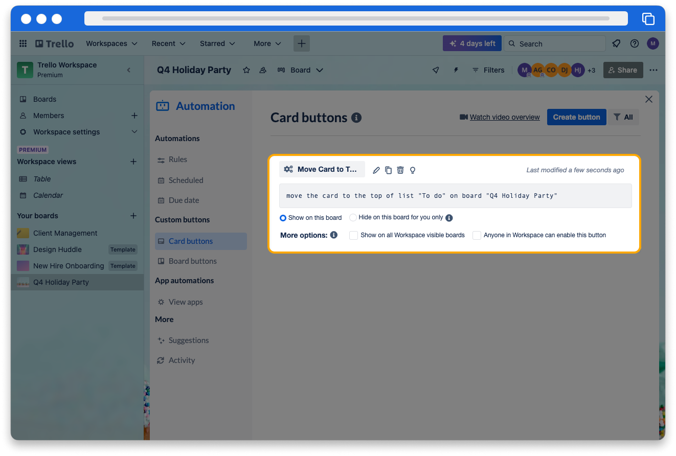

Create card and board buttons
In addition to rules, you can create custom buttons that perform pre-defined tasks. Where rules are triggered automatically when something happens on the board, button actions are triggered by clicking on the button whenever you need it. You can create two types of buttons:
  • Card buttons automate workflows on a card level, such as adding a label or joining a card. They appear as buttons on the back of every card on the board.
  • Board buttons automate workflows on a board level, like reordering cards in lists or creating new lists. They appear as buttons above the board.
👇 In this example, the card button “Move Card to To Do” moves a card to the top of the list “To Do”.
A screenshot of the Card Buttons page in board Automations. The rule “move the card to the top of list “To Do” on board “Q4 Holiday Party” is highlighted and titled Move Card to To Do.
With buttons, the trigger is clicking on the button, so you only need to specify the button’s icon, title, and the action you want it to perform.
👇 Click the tabs below to see examples of how card and board buttons can be used.

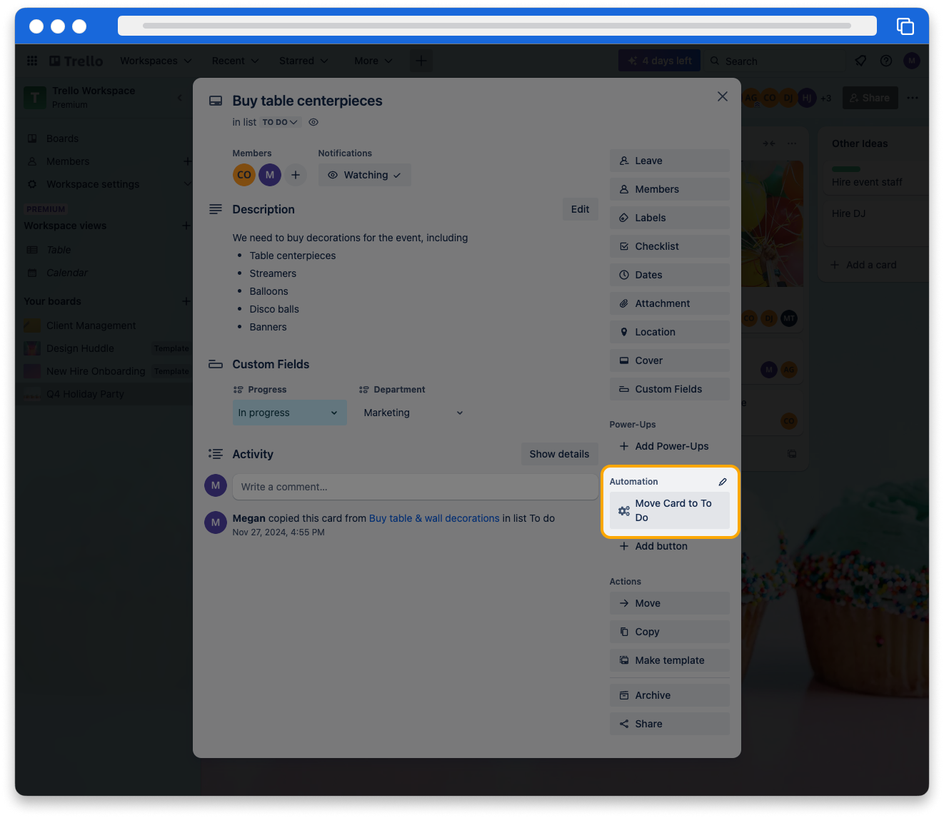

👇 The card button “Move Card to To Do” moves a card to the top of the list “To Do”.
A screenshot of the backside of a Trello card with the card button “Move Card to To Do” highlighted on the right side of the card.
You can create both types of custom buttons in Trello from the Automation directory’s automation builder. Card buttons can also be created directly from the back of a card. All buttons you create can be viewed and managed from the tabs in the Automation directory.

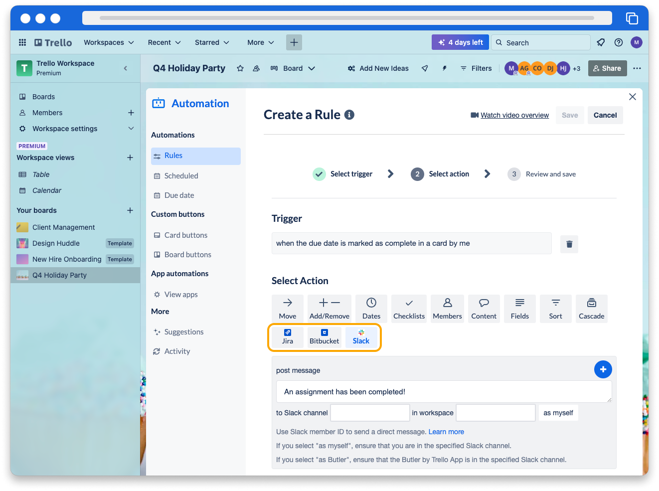

Once you connect your applications in Trello, you can select and customize actions for your automation rule or button in the Jira, Slack, or Bitbucket tabs of the action screen.
👇 Select automation actions from the Jira, Bitbucket, or Slack tabs.
A screenshot of the Create a Rule page in the board Automations. The 3 options for Jira, Bitbucket and Slack actions are highlighted in the Select Action step of creating a new rule.
