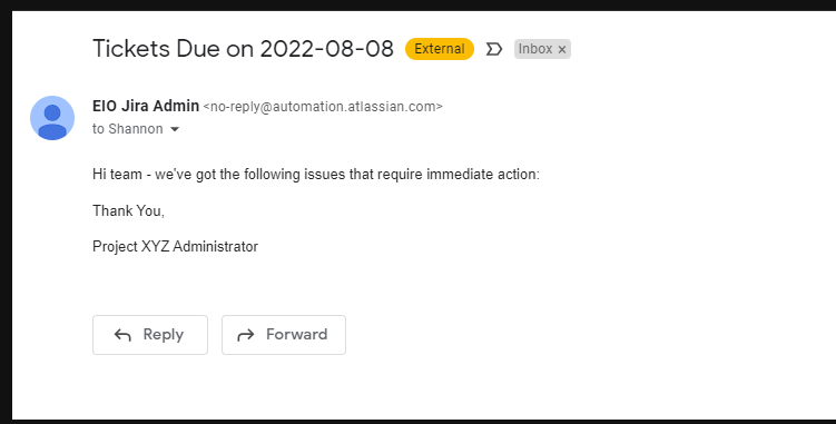

For Step 2, however I do not get any data when I use the lookup command
Inputs:
Result:

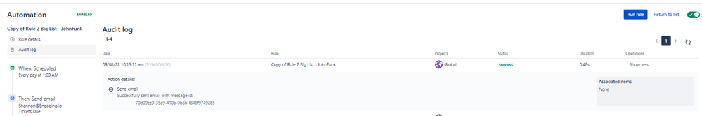

My log audit is empty as well..

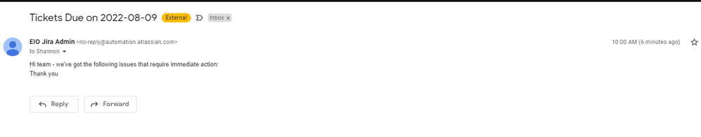

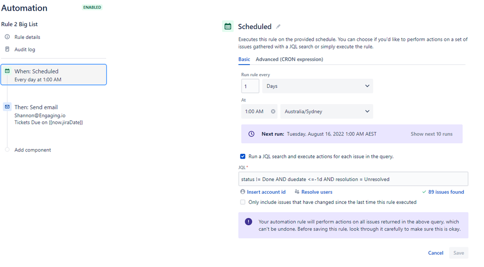

I thought that maybe it was because I turned off the JQL search query against the schedule task, but when I turn that back on, I get a blank message for each overdue issue.

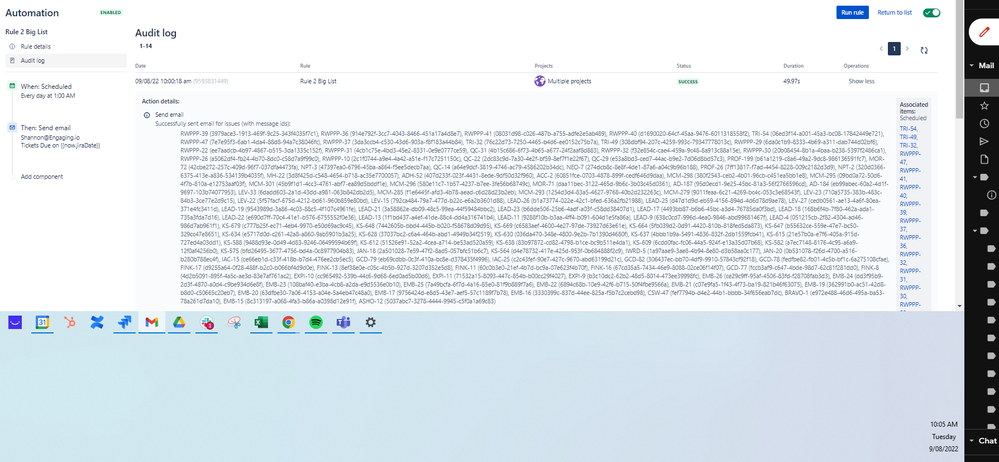

Even in that instance the email still shows empty, but the Audit Log has all the issues:

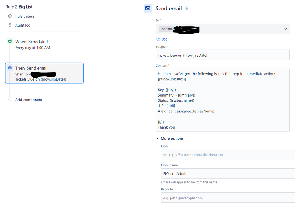

Ah I see. The point is:
if you unselect the jql you don´t get any issues. On the other hand if you check the check mark (as the information tells) the action is done for each issue from the jql result.
Therefore I would suggest the following procedure:
  • turn off the jql in your schedule trigger
  • add a lokkupIssue action right after your trigger with the jql you would like to process
  • the rest should then work fine as expected.
I did a small test inide my site which looks like the following:
Please let me know if this was helpful.

@Stefan Salzl , I cannot believe I forgot the most fundamental part of the Lookup *facepalm*
Once I added that piece in, of course it worked!

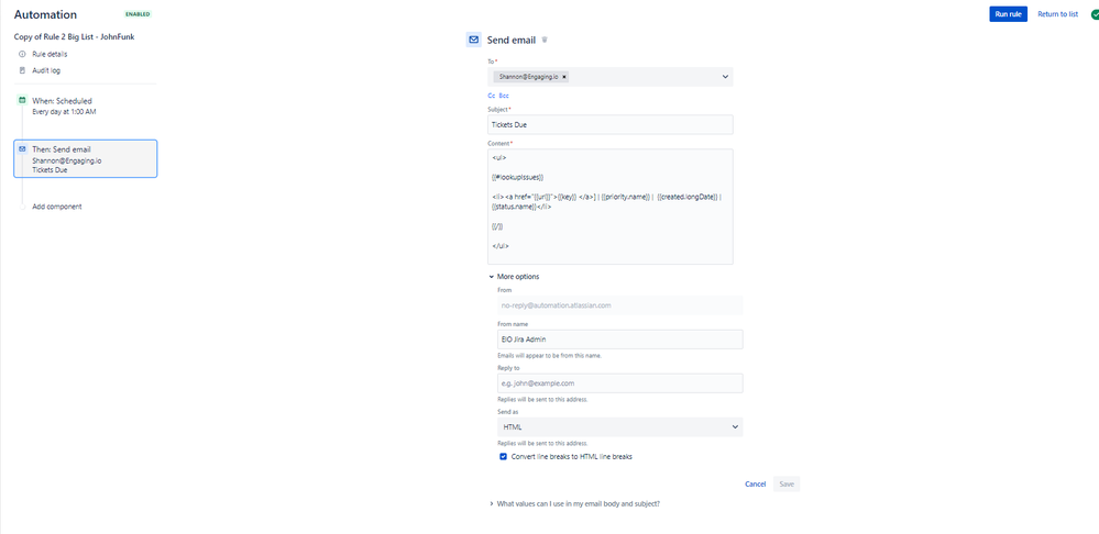

August 8, 2022
Hi @John Funk
Same error when I use your suggestion:

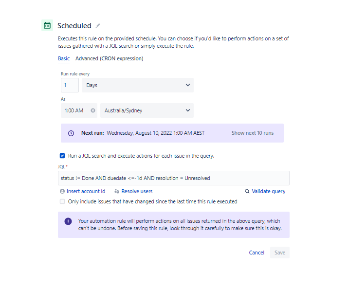

But in this case, it doesn't appear that you are actually selecting any issues. Can you share a screenshot of your Scheduled step? You should have some JQL there.

August 14, 2022
Hi @John Funk ,
Pardon the delay, I was at a conference.
JQL information as requested:
