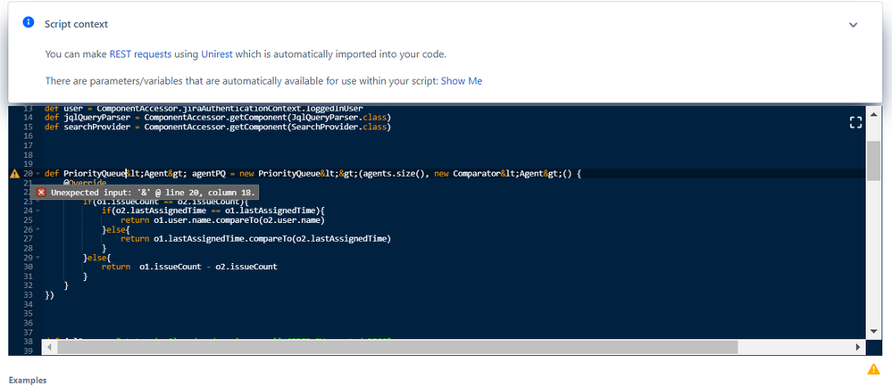

Mayur Gaikwad/Tech PMO
February 5, 2024
Im getting below error when using this
