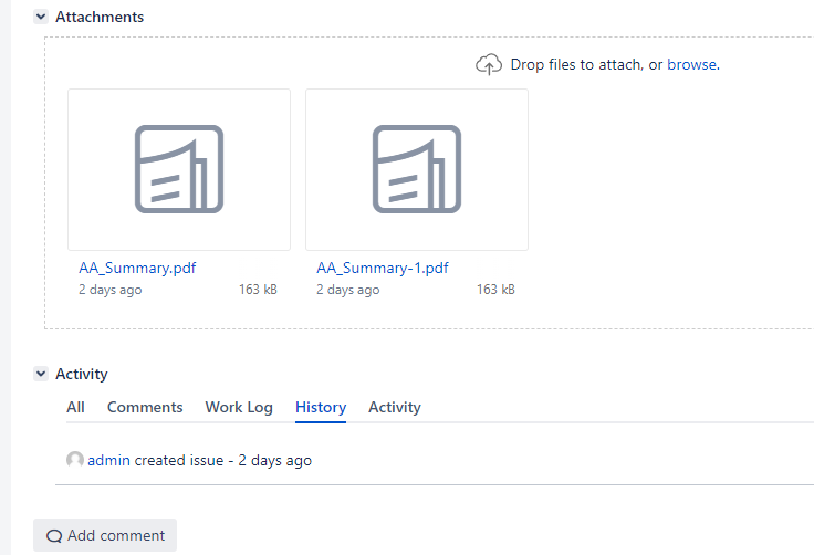

I used Jira API to write a function to copy attachments to another issue like below:
public void copyAttachmentsToAnotherIssueWithKey(
final String targetIssueKey,
final List<Long> attachmentIds
ApplicationUser currentUser = jiraAuthenticationContext.getLoggedInUser();
List<Attachment> attachments = attachmentIds.stream().map(attachmentManager::getAttachment).collect(Collectors.toList());
attachments.forEach(attachment -> attachmentManager.copyAttachment(attachment, currentUser, targetIssueKey));
It copied successfully, but in the 'History' of the target issue, there is no update.
Furthermore, when I used JQL search with 'attachments is not EMPTY', the target issue was not in the results although the attachments already exist in the target issue.
Could you provide me with a solution? Thanks.
I found the solution to update the changelog with ChangeItemBean and IssueUpdater.
Issue targetIssue = issueManager.getIssueObject(targetIssueKey);
attachments.forEach(attachment -> {
attachmentManager.copyAttachment(attachment, currentUser, targetIssueKey);
Issue issue = attachment.getIssueObject();
List<ChangeItemBean> changeItemBeans = changeHistoryManager.getChangeItemsForField(issue, "Attachment");
if (!changeItemBeans.isEmpty()) {
ChangeItemBean latestChangeItemBean = changeItemBeans.get(changeItemBeans.size() - 1);
ChangeItemBean newChangeItemBean = new ChangeItemBean();
newChangeItemBean.setFieldType(ChangeItemBean.STATIC_FIELD);
newChangeItemBean.setField("Attachment");
newChangeItemBean.setFrom(latestChangeItemBean.getFrom());
newChangeItemBean.setFromString(latestChangeItemBean.getFromString());
newChangeItemBean.setTo(attachment.getId().toString());
newChangeItemBean.setToString(attachment.getFilename());
newChangeItemBean.setCreated(new Timestamp(System.currentTimeMillis()));
List<ChangeItemBean> newChangeItemBeans = new ArrayList<>();
newChangeItemBeans.add(newChangeItemBean);
IssueUpdateBean issueUpdateBean = new IssueUpdateBean(targetIssue, targetIssue, EventType.ISSUE_UPDATED_ID, currentUser);
issueUpdateBean.setChangeItems(newChangeItemBeans);
issueUpdateBean.setDispatchEvent(true);
issueUpdateBean.setParams(MapBuilder.build("eventsource", IssueEventSource.ACTION));
issueUpdater.doUpdate(issueUpdateBean, true);
