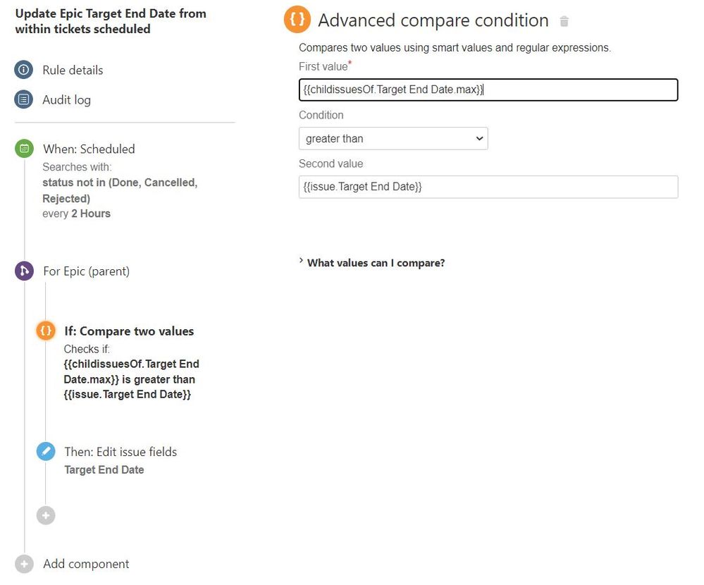

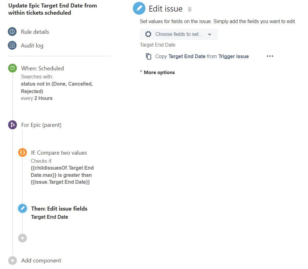

Hi, I have created a rule to update date Epic from child issues, but how to do it for already set dates - check now the dates and update? I can't manage to make the syntax; this below doesn't work:
you can try this automation
Trigger : scheduler.
with JQL : project = [project key] AND issuetype != Epic ORDER BY cf[custom field ID for Target End Date] DESC
then advanced compare
{{Issues.Target End Date.max}} greater than {{issue.parent.Target End Date}}
then create variable for {{Issues.Target End Date.max}} lets say the name is TEST
then add branch rule for EPIC (parent)

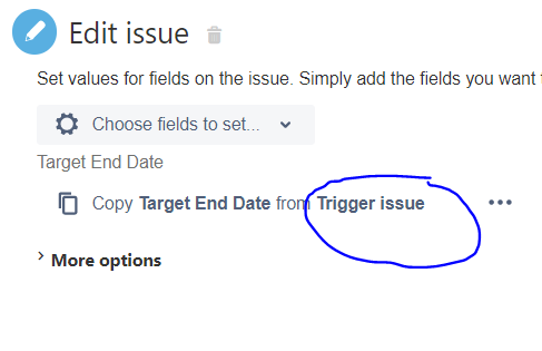

edit the field you want and set it to smart value {{TEST}} instead of usinng copy from trigger issue

The advanced compare is what I can't manage - {{lookupIssues.Target End Date.max}} doesn't work; can you propose syntax that I can use to filter tickets within Epic?
It's not working; ({{TriggerIssue.Target End Date}}) is also not working as there is no trigger - I need to execute check for all tickets as they are now.
Also tried {{child.issue.Target End Date.max}} - not working.
Any idea of other syntax?
Yes, sure; schedule is simple - tickets not Done, Cancelled or Rejected, every 2hours and:
It didn't work; tickets didn't march the rule.
I think even with previous syntax is could work, but due to the fact that there is no trigger as it's a scheduled change, no change will happen:
Yeah, that's the issue with Scheduled. You might try doing the scheduled rule, and set a value on the Epic. Then do your trigger based on that field changing on the Epic. Then maybe you could use Trigger Issue.
