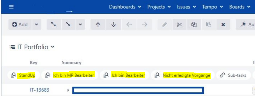

Hi,
is it possible or is there a way to add a DropDown list to the filters as in the screenshot? For example a DropDown list to select the status.
Greetz
Ersin

hello @Ersin Eromay
I want to add multiple Tranformations-JQL-Filters in structure , as all highlighted in attached screenshot, please provide some function to add or a script.
Thanks in Advance
