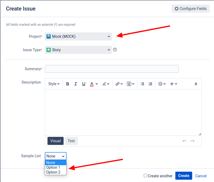

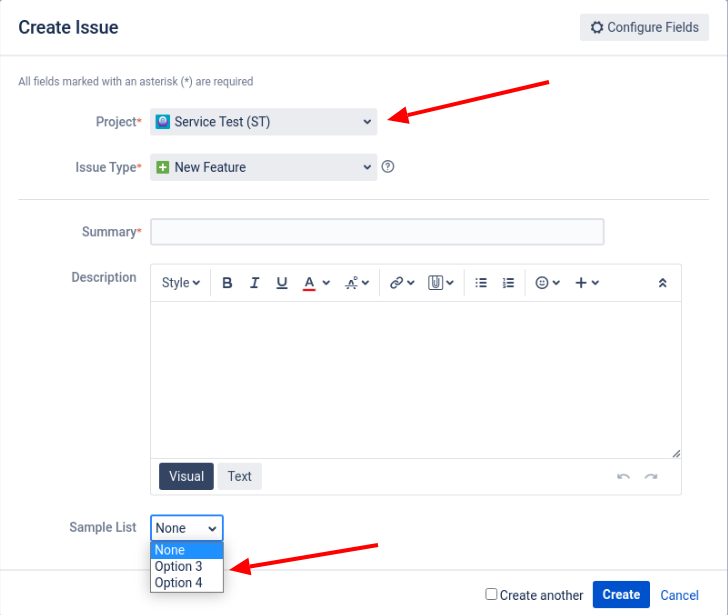

Below is a screenshot of the Behaviour configuration:-
If you observe the screenshot above, the Behaviour is configured for two projects, i.e. Mock and Sample Test.
In the Initialiser section, the conditions are added to determine what value will be set to the list's option when the project is changed.
So in this example, if the project is MOCK, the list will display options Option 1 and Option 2, and if the project is Sample Test (ST), the list will display options Option 3 and Option 4.
Below are a couple of test screenshots for your reference:-
1) If the project is MOCK, the Sample List will be filtered to Option 1 and Option as shown below:-
2) If the Project is Service Test, the sample List will be filtered to Option 3 and Option 4, as shown below:-

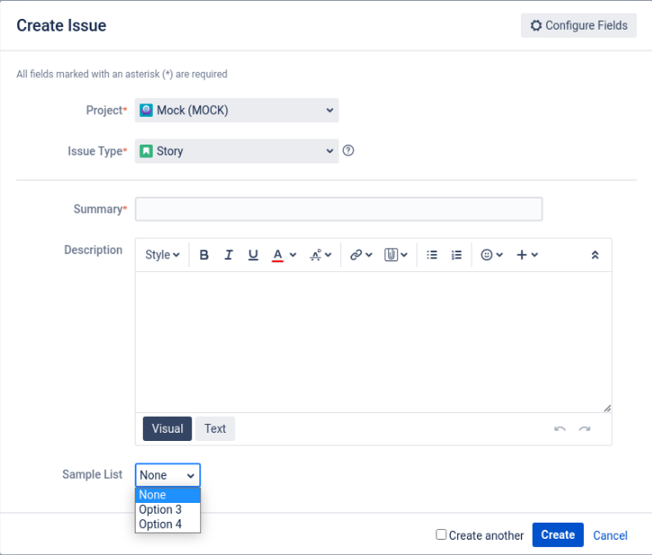

If you want to do it with different issue types instead of different projects, the approach is pretty much the same.
You will need to modify the code to something like:-
import com.onresolve.jira.groovy.user.FieldBehaviours
import groovy.transform.BaseScript
@BaseScript FieldBehaviours behaviours
def sampleList = getFieldByName('Sample List')
def issueType = issueContext.issueType.name
def options = []
if (issueType == 'Bug') {
options = ['Option 1', 'Option 2']
} else if (issueType == 'Story') {
options = ['Option 3', 'Option 4']
sampleList.setFieldOptions(options)
Please note that the sample working code above is not 100% exact to your environment. Hence, you will need to make the required modifications.

Below is an updated screenshot of the configuration for your reference:-
1) If the issue type is a Bug, only Option 1 and Option 2 are displayed.
2) If the issue type is Story only Option 3 and Option 4 are displayed.story_type.png
I hope this helps to answer your question. :-)

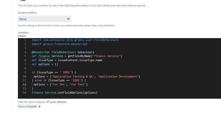

Manoj
June 9, 2023
@Ram Kumar Aravindakshan _Adaptavist_
Hi, sharing below screen shot for reference, I did check on finance service, it has space between finance & service and i have maintain the same while writing the script.
pls see the screnshot and 1 important thing these 2 issue has different workflow.
Do i need write separate code for the same.? kindly suggest. Test behavior.jpg
Manoj
June 9, 2023
@Ram Kumar Aravindakshan _Adaptavist_ Hello again,
i have observe the script shared by you again, carefully indeed and got to know what i was missing.
def financeService = getFieldByName('Finance Service'
i was keeping finance service same everywhere while writing hence it was not working.
Thanks alot again @Ram Kumar Aravindakshan _Adaptavist_  you made my weekend. now i can work further on this project as major one achieved.
