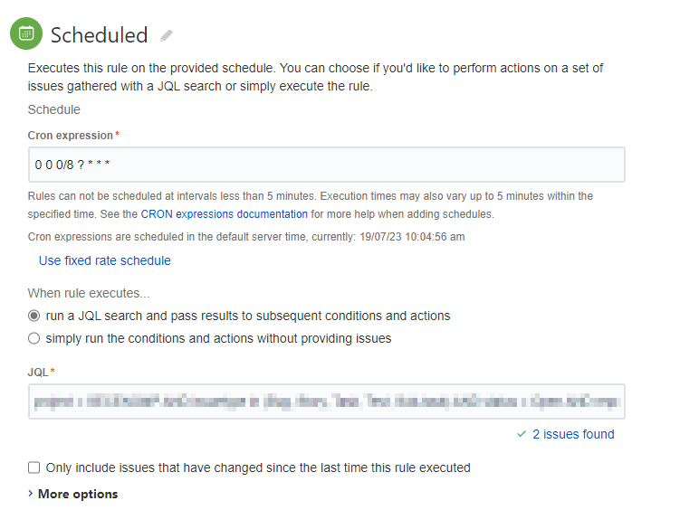

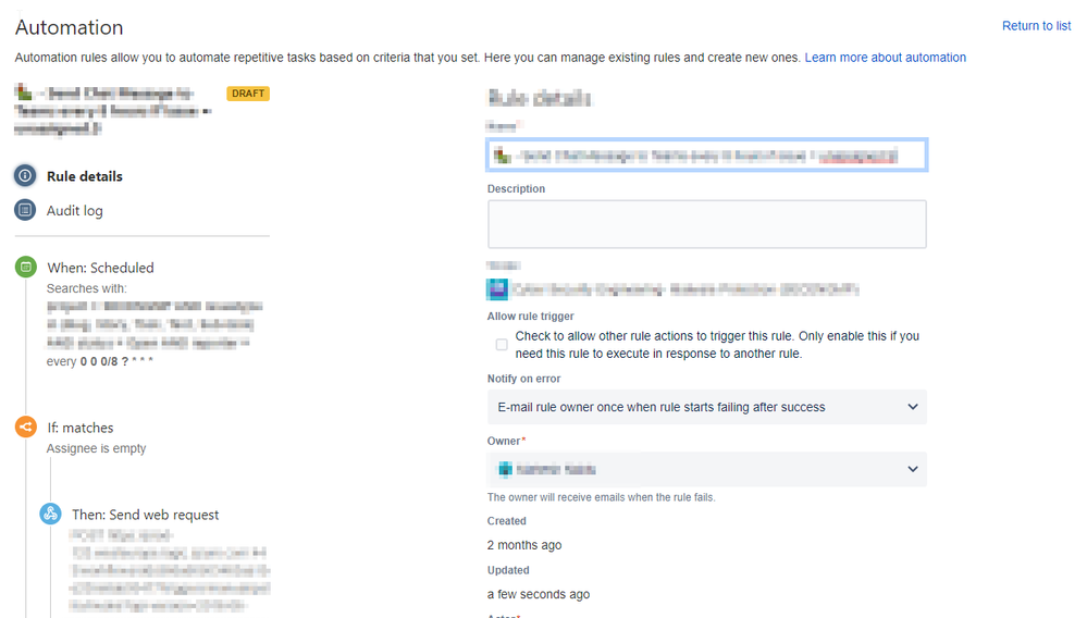

I was wondering if someone can help with this automation I have created.
The Automation is fairly simple.
  • Using a CRON schedule - every 8 hours it checks a JQL query
  • The JQL query, searches a Project for Issues that don't have an Assignee
    • As of today this has found 3
  • It then does a If Statement looking at the passed Issues from the JQL
    • If Assignee = Empty
    • Run a web request.
The issue I am having is that
The JQL query in the schduled trigger is finding issues, but not triggering with the "No Actions Performed" response in the audit.
I was wondering if someone could advise or let me know what I am missing?
This did work before the 10th June but since then it hasn't.
the JQL used is as follows:
project = ****** AND issuetype in (Bug, Story, Task, Test, Sub-task) AND status = Open AND reporter = ****api account*** and assignee is empty

the JQL query in the schedule is seeing 3 issues so I thought it would send these 3 to the next step, as the below is selected.
When rule executes...
run a JQL search and pass results to subsequent conditions and actions

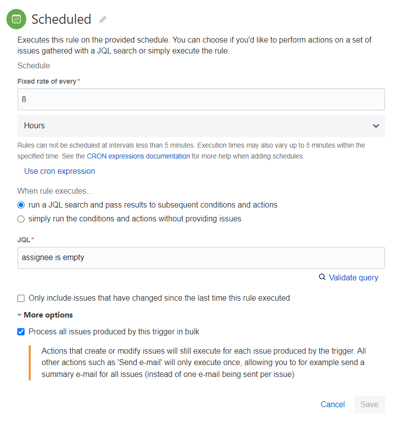

@Richard Blakemore, that's interesting. What if we copy this rule and build it a little differently?
Try to use Fixed rate of every 8 hours, add your JQL and check Process all issues produced in bulk:
Then delete the condition as "Assignee is empty" is already present in JQL and add the "Log action" with "{{issues.size}} issues found." to write the entry in the rule log:
Run this rule copy and let me know the results from the log.
