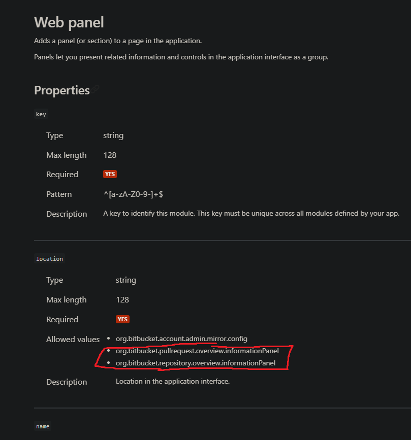

Also (I didn't get into that a lot, But),  To create the desired plugin I would need to refer to some of your modules interfaces. Do you think those values would be sufficient to do what I want to achieve (aka. show code coverage as color-coded block)
On the Bitbucket Server solution you have CONTEXT and refer to fileContext  AND Bitbucket Server web resource contexts (that I would need to achieve in mine Bitbucket CLOUD)
