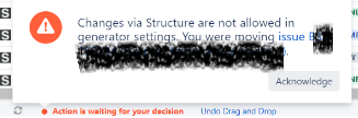

Nishant Paraskar September 28, 2022
Untitled.pngcan anyone help me to understand why i am getting
"Changes  via structure board is not allowed in generator Setting"
This issue is coming when we are adding the issue using "Drag and Drop"
