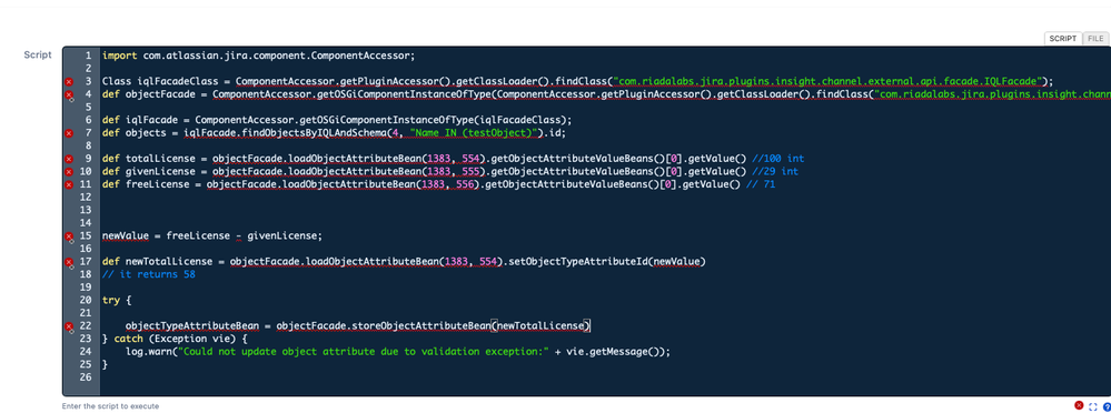

Hello! Im trying to calculate insight attributes of the certain object, it returns value, but i can 't store ( change value in insight). Have any ideas how to solve this problem? :(

I see a couple of things wrong with your script.
1) loadObjectAttributeBean may return a null if that attribute is not populated.
2) You need to create a ObjectAttributeValueBean to add to the ObjectAttributeBean, you can't just set it with setObjectTypeAttributeId
If you are 100% confident that attributes 554, 555, and 556 will always be populated, you can keep that section as is, otherwise, you should split the loadObjectAttributeBean and the getObjectAttributeValueBeans into separate lines and check if the first exists before accessing the second (and probably skip the rest of the script if it doesn't exist).

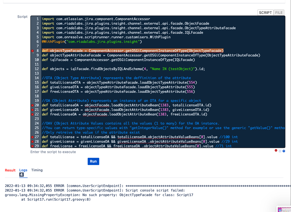

Daniil Mazurin
January 12, 2022
@PD Sheehan
Hello, thank you so much, i also input next bunch of code ( because 3 imports turns in red):
import com.onresolve.scriptrunner.runner.customisers.WithPlugin
@WithPlugin("com.riadalabs.jira.plugins.insight")
But i still have an errors :(
PD Sheehan
January 13, 2022
Looks like I made some cut/paste mistake somewhere along the way ...

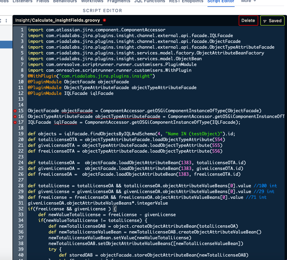

PD Sheehan
January 13, 2022
On the second screenshot, delete lines 15-17 ... they are duplicated of 10-12.
But if you are going to use this in Insight Automation, you can't user scriptrunner to validatate. The first screenshot is expected to have errors. But the script will compile and execute correctly by insight.
