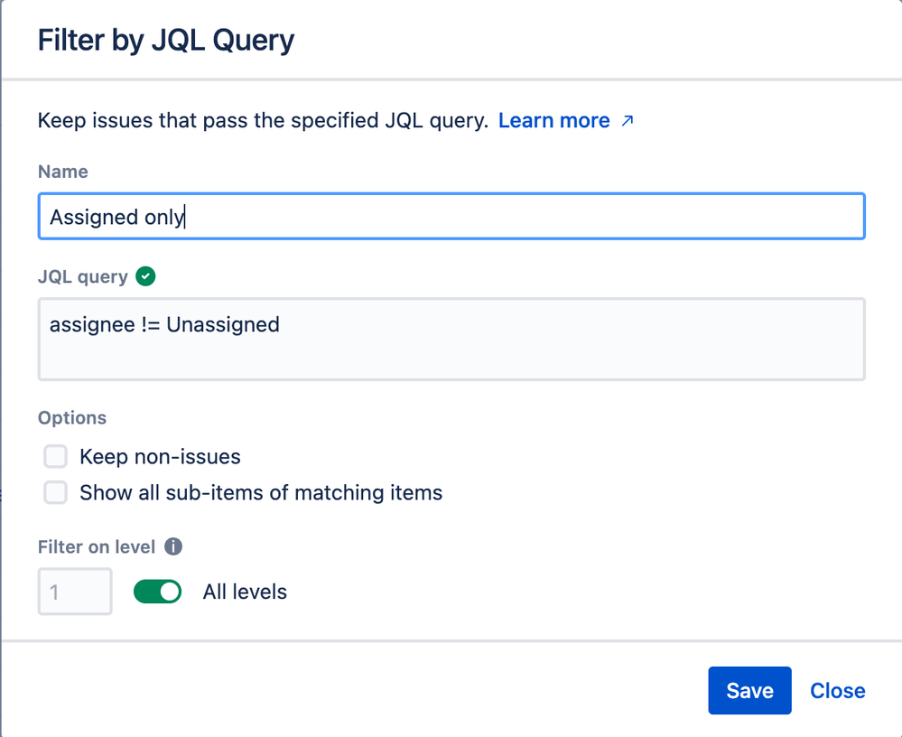

Hi, you can click on the filter icon on the right and then click on + New filter to create a Filter with your Name of choice and JQL query assignee != Unassigned
and toggle it on/off to hide/show unassigned issues.

Hi @Marina Shelestiuk ,
If you click +Add button next to "Show Generators", you will see a Filter option.
Use the same filter @Dave Mathijs recommended and it will be permanently applied to your structure.
Hope this helps!
