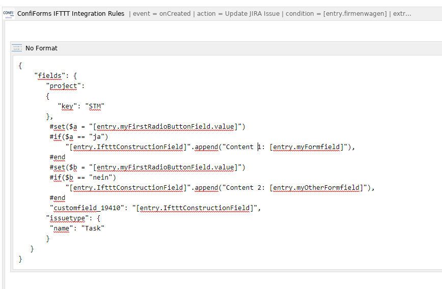

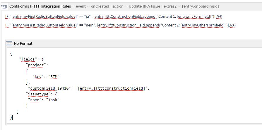

Approch 1 (which is probably the most promising)
I use an IF-function and the virtual function append() outside the 'No Format' area. I use a Confiforms form field called 'IftttConstructionField' to append my content to.
That field 'IftttConstructionField' I use again in the 'No Format' section where I build my json to allocate the value to the Jira custom field 'customfield_19410'.
As far as I understand it from the docs, it is possible to use virtual functions and the IF-function within the IFTTT-Body. That's why I think this could therotically work.
Approach 2
My second approach tries to use the virtual function append() within the 'No Format' area. This way I don't have a problem with the Conditional Statement, but using virtual functions within the 'No format' section doesn't seem to work:
(I tried a lot small syntax changes but maybe never got it quite right)

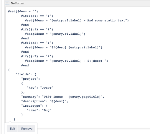

Sorry, I am confused... still unsure why you need a virtual function of any kind here
What you need is just a Velocity #if #end statements to define and collect information into the "Velocity" template variables
I will give you an example how you can "collect" values into the Velocity defined field and then use it's value in the JSON
Below, I have a form with 2 radio fields (r1 and r2, each having 2 choices 1 and 2)
See how I can format the "description" field based on the choices my user makes on the form
No virtual functions... just pure Velocity templating
Like Christopher Lanphear likes this
Manuel_vA
July 18, 2020
Hello Alex,
with your last sample code, you completely solved my problem! Thanks a lot. Great help!
I tried that approach before but I was incapable of simply using the $desc variable again on the right side of the variable assignment like you did it for example in this line:
#set($desc = "$!{desc} [entry.r2.label]")
(I didn't necessarily want to solve this by using virtual functions, but it was the only idea I had left..)
