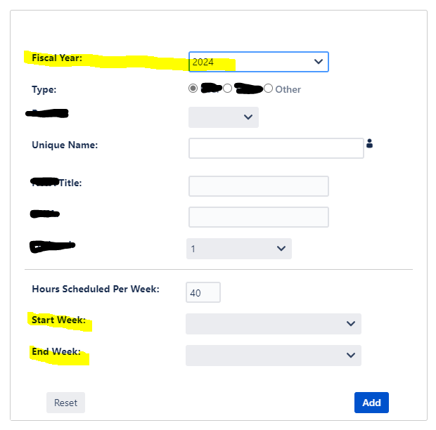

I have a form where the user enters a Fiscal Year. The Fiscal Year is a normal dropdown. From that, the Start Week and End Week are populated with data from the Weeks ConfiForm - both are smart dropdowns, and work just fine. There are some instances where no Start Week or End Week are necessary. When these are left empty, the IFTTT macro will no execute. I've removed all associated rules, so I know it's not the rules on the Start Week or End Week fields. Therefore, I would like a way to set the default Start Week and End Week.

I would set the default Start Week to either this week, if it's the current fiscal year, or 1 if it is in the future. The End Week should be the last entry, wither week 52 or 53, depending on how many are in the Fiscal Year. I don't need them at all for type "Other", and I have a rule that hides the bottom fields. Right now, if I enter all of the data, but don't select a Start Week or End Week, my onCreated IFTTT macro will not execute.

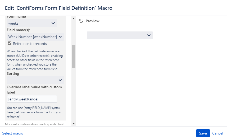

The start week and end week are both Smart dropdowns and get their data from the Weeks Table:

I'd like to set default dates, but they aren't required for all types. I *do* however always need the onCreated IFTTT macro to execute. Right now, it will only execute if dates are selected in the smart dropdowns.
