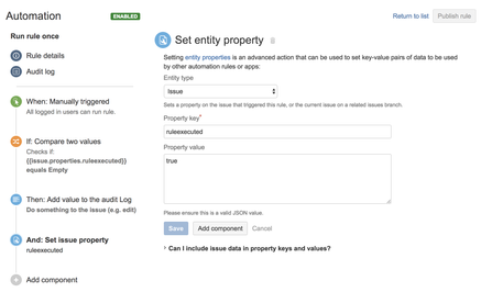

Another way that's invisible to users is to use entity properties. Your rule would look like this:
  • Trigger: Any trigger
  • Compare condition:
    • First value: {{issue.properties.ruleexecuted}}
    • Equals:
    • Empty (leave field blank
  • Action: Do something like editing the issue
  • Action: Set entity property 'ruleexecuted' = true
It looks like this in practice:
The actions in this rule will now only execute once for a given issue.  After that, the compare condition will fail since the issue property has a value.

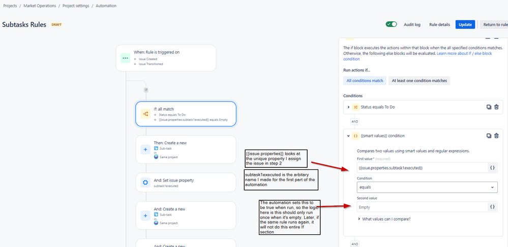

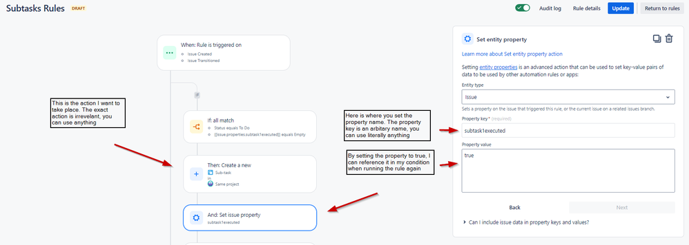

  1. Because I want the same rule to run based on different conditions, I am using If/Else. The first condition checks my conditions as well as the issue property

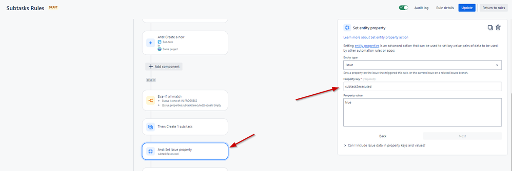

  2. Later in this section, I set the actual property name. prevent_duplicate_rule_2.png
  3. You can rinse and repeat for additional if/else statements, just come up with a new property name. Here's the section for new subtasks:
