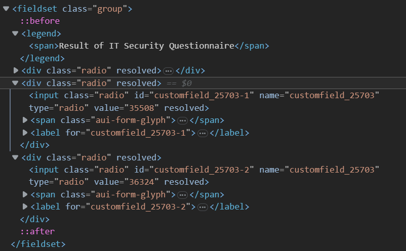

Here is the 'inspect' view of the field. As you can see, the options has their own customId's, but even that doesn't work.

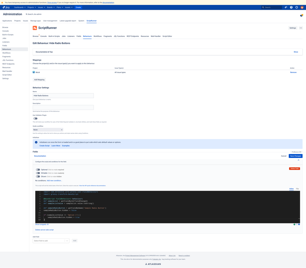

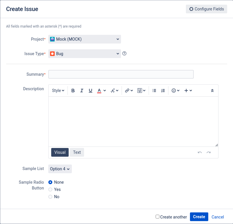

Below is a screenshot of the Behaviour configuration:-
This Server-Side Behaviour above has been added for the Sample List field, and when Option 1 has been selected from the Sample List field, the Radio Buttons will be hidden.
For all other options, the Radio Button will be visible.
Below are a couple of test screenshots for your reference:-

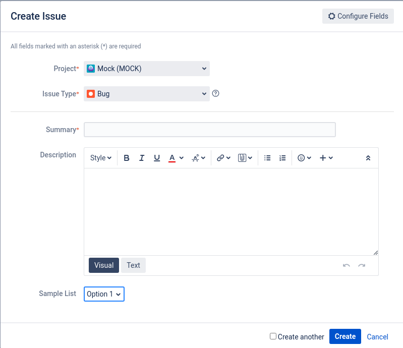

1. The Radio Button is hidden as expected when Option 1 is selected from the Sample List.

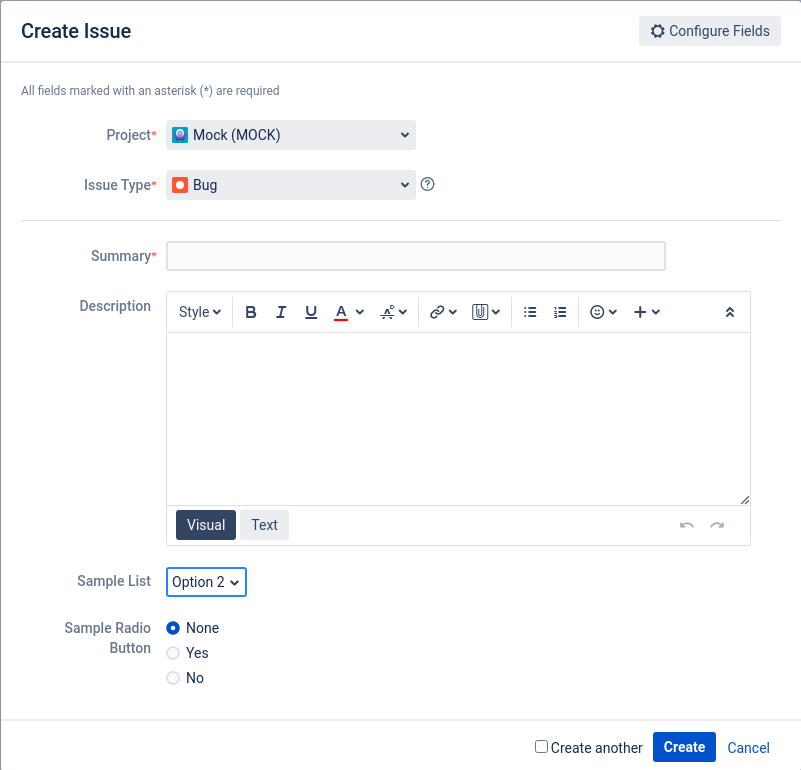

2. When other options, including None, are selected from the Sample List, the Radio Button is visible as shown in the screenshots below:-

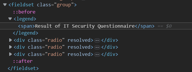

It's almost as if the radio button field has no 'name'/'id' for some reason.
With every other fields it works (They have a customfield_id)

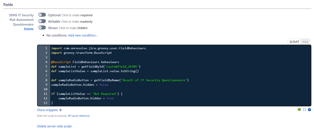

Here is what I tried :
(The customfield_26306 is the field having the list in which we can choose 'Not Required')
