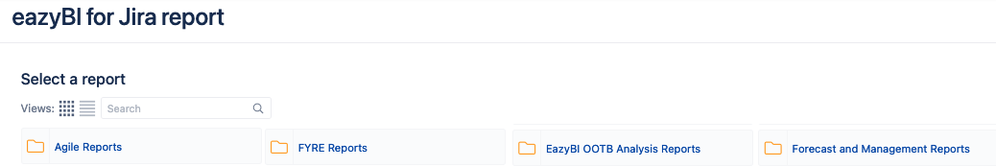

I am currently using the "eazybi for Jira report" app for publishing eazybi jira reports on confluence. When I select this app, I am linked to my EazyBi account and can select the jira report I was to display in confluence
This works great and I can see my eazybi report in confluence. My only problem is that I can't export this to PDF.

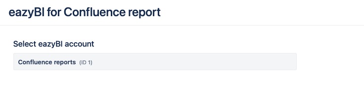

I followed the instructions here: https://docs.eazybi.com/eazybi/publish-reports/publish-in-confluence-pages, and if I select the "eazybi for Confluence report" app I only see "sample" confluence reports and I don't have access to my jira reports.
Is there a setup step I'm missing or should this work.
I am not using jira gadgets, only the "eazybi for Confluence report" which should allow "Published reports and dashboards are included in page export to PDF and Word document as well." (from documentation)
