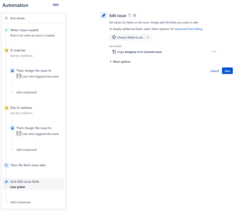

I have an automation rule that is triggered on Issue Creation, and if Assignee is empty, it sets the value based on a custom field. It is a series of If/Else blocks
What I would like to be able to do: In the same automation rule, AFTER the If/Else block is finished, set another custom field based on the Assignee setting.
What I have tried:
  1. Creating another rule that has "allow other rule actions to trigger this rule" checked. It is triggered by Issue Creation + Assignee not empty. It does a re-fetch and then sets the second custom field based on Assignee. It didn't work.
  2. Adding a re-fetch and setting the second custom field in every single block after Assignee is set. This works, but is very inelegant and hard to maintain.

Hello @Tzirel Shaffren ,
You should be able to do this:
You should be able to add the components after if/else without a problem. Or have I misunderstood?
Adam

Thanks so much for your quick answer!
You exactly understood what I wanted. For some reason it didn't work for me. But now I will try it again with the help of your image and see if I can get it to work.
Tzirel Shaffren
June 21, 2023
Works like a charm - thanks!
